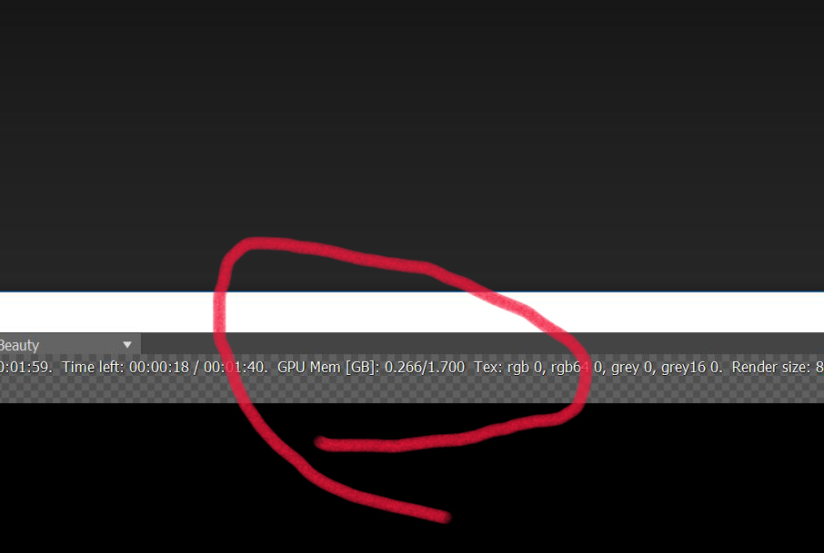

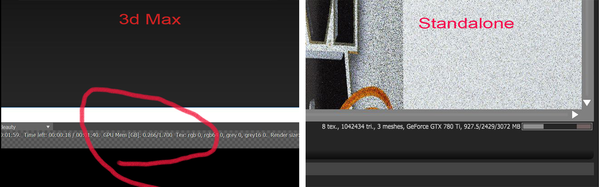

Thank you for advice I am aware the situation. I know Win 10 eats vram but I need to use rest of vram. I am also using Standalone and it's ok when I use my 780ti. I think it is kind of bug for 3d Max. I hope I could express my problem.

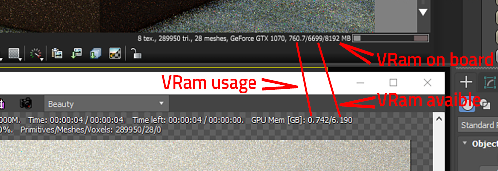

- paride4331
- Posts: 3992
Hi Buraq,
I do not think any issue about Vram Usage.
As you can see in the screenshot, everything is right.
Octane Render Stand Alone needs less Vram than 3dsMAx, but that's right.
In your case is:
3072 Vram on board (780ti)
1700 Vram avaible (around -20% windows - 3dsMax)
Regards
Paride
