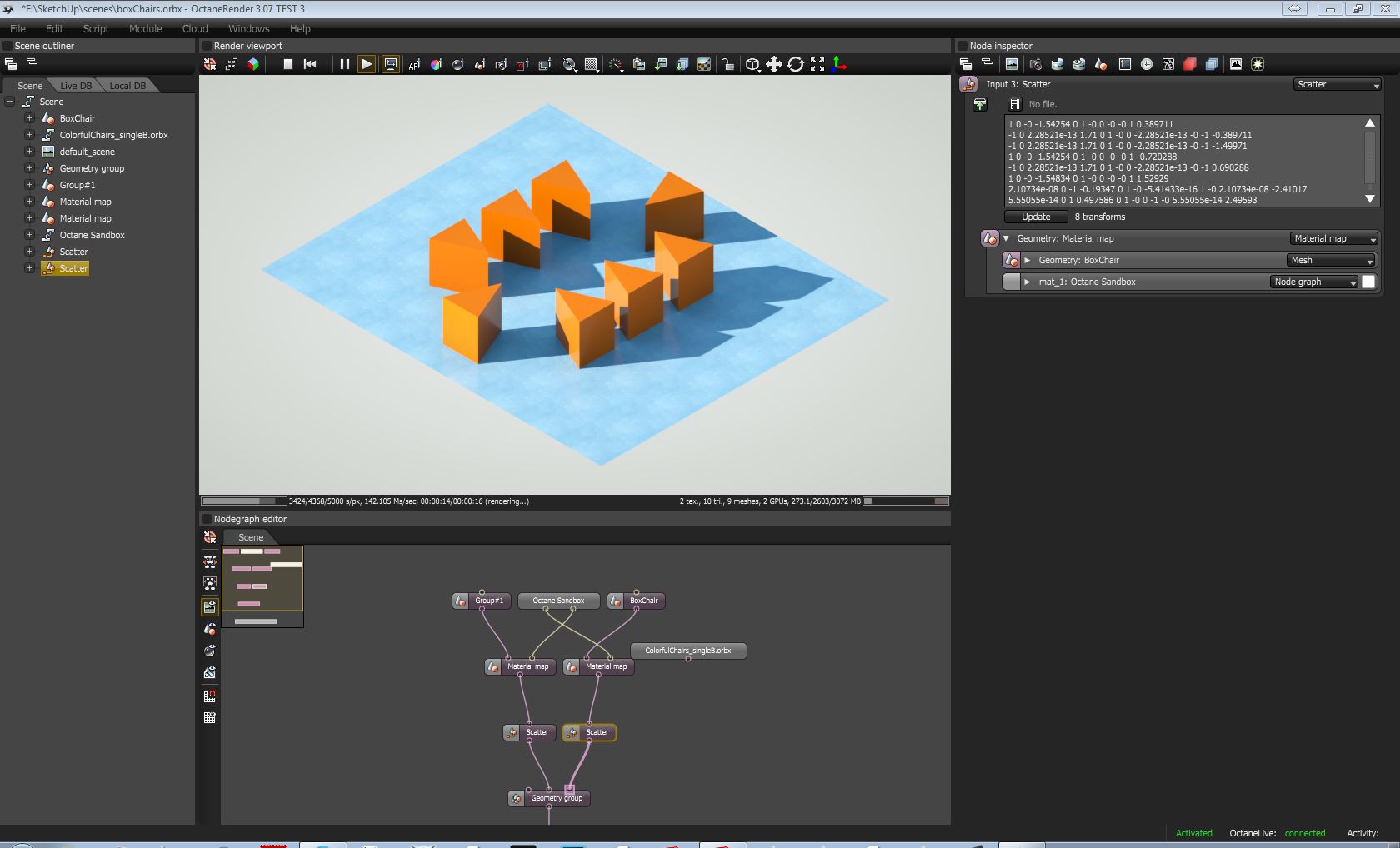

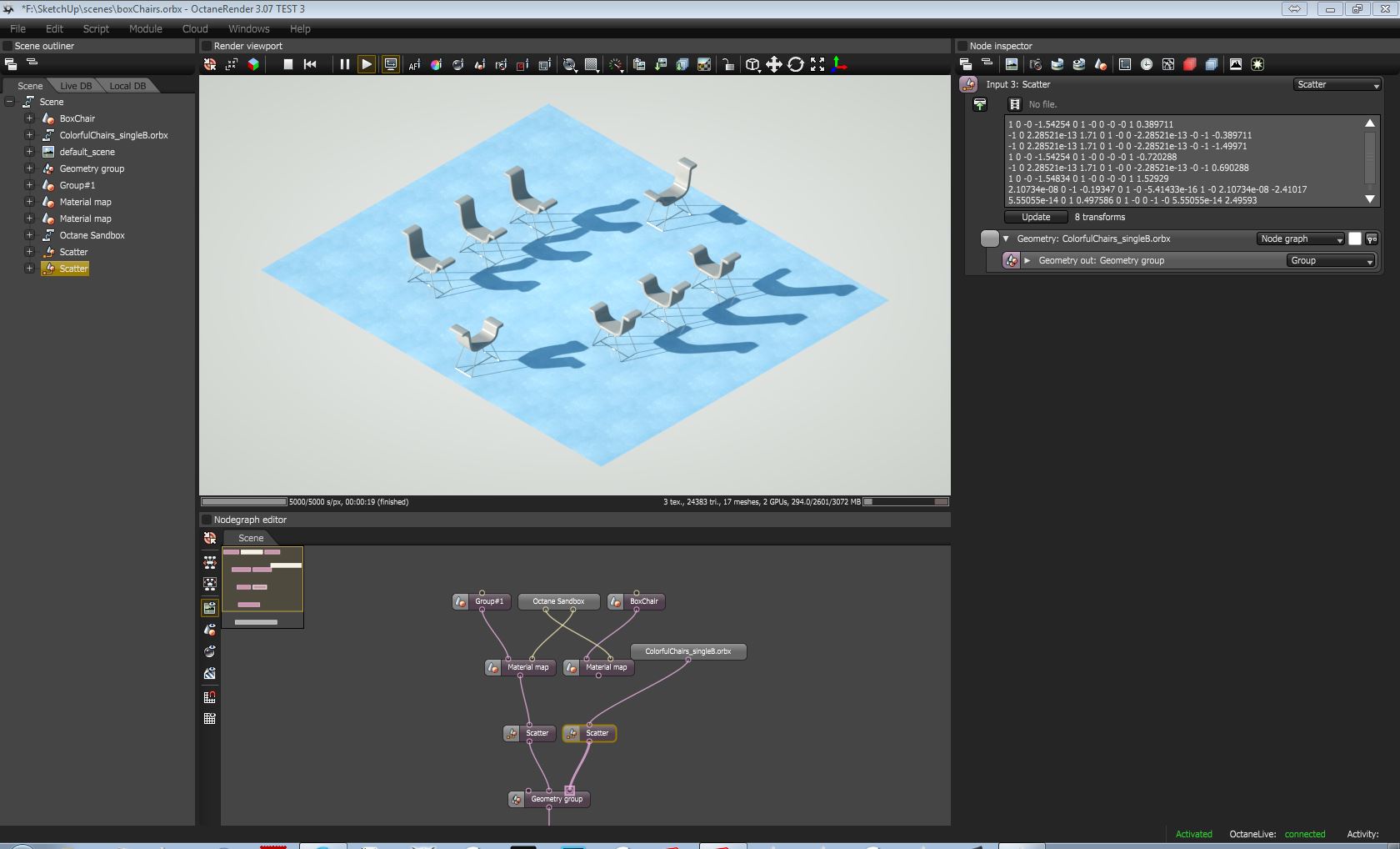

Posts: 10579
Hi jorgensen,
you can use a cube or a plane, with similar proportions, as a guide for scattering:
What is important is to have a proper scatter node with all the correct matrix for each instance.
Then you can export/import the single obj object to replace the cube:
SkatterTest.orbx
(3.53 MiB) Downloaded 192 times
ciao beppe

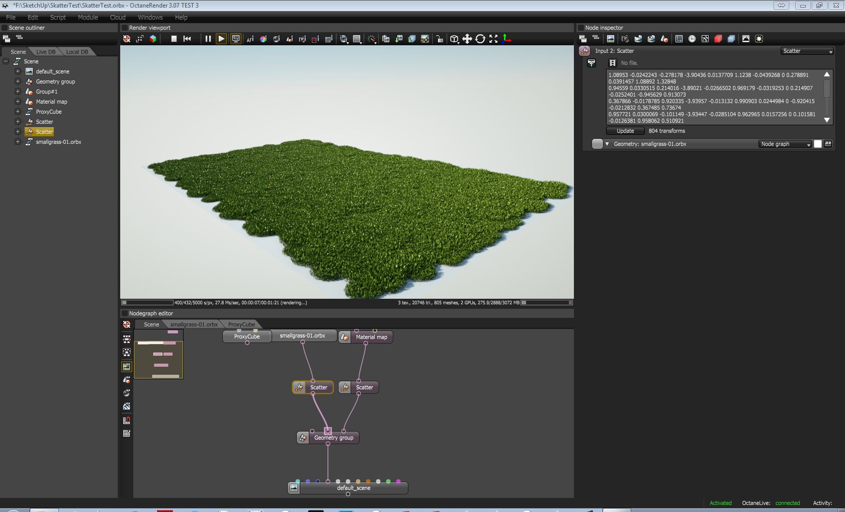

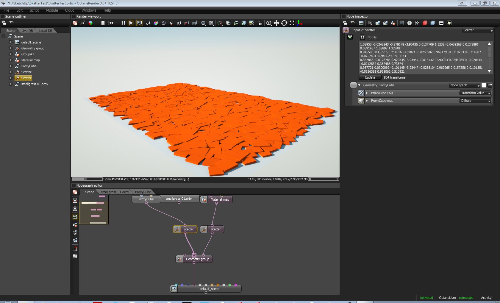

Posts: 10579
Hi jorgensen,
please, have a look at this other example with sketchup files:
scatterExample2.7z
(13.74 MiB) Downloaded 205 times
As you can see, any component is exported with proper scatter node from Sketchup:
So you only need to import and connect the correct model to replace the base object:
ciao beppe
