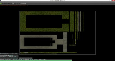

Thank you for that simple breakdown bepeg4d - I was missing the last stage of looking in the Live Viewer to see the baked texture ! I was looking for a button to hit like the native C4D bake and couldn't figure how to actually start the baking process...
But I have one small issue now - the baked texture is not square as per the UV (see screenshot). How can I make it square in the Live Viewer like the UV mapping? And how do we export out the separate channels as PNGs here (I can only seem to access the individual ones through a layered PSD file?) Selecting the individual render passes in the Live Viewer and trying to export PNG only seems to export the whole thing.
Thanks!
