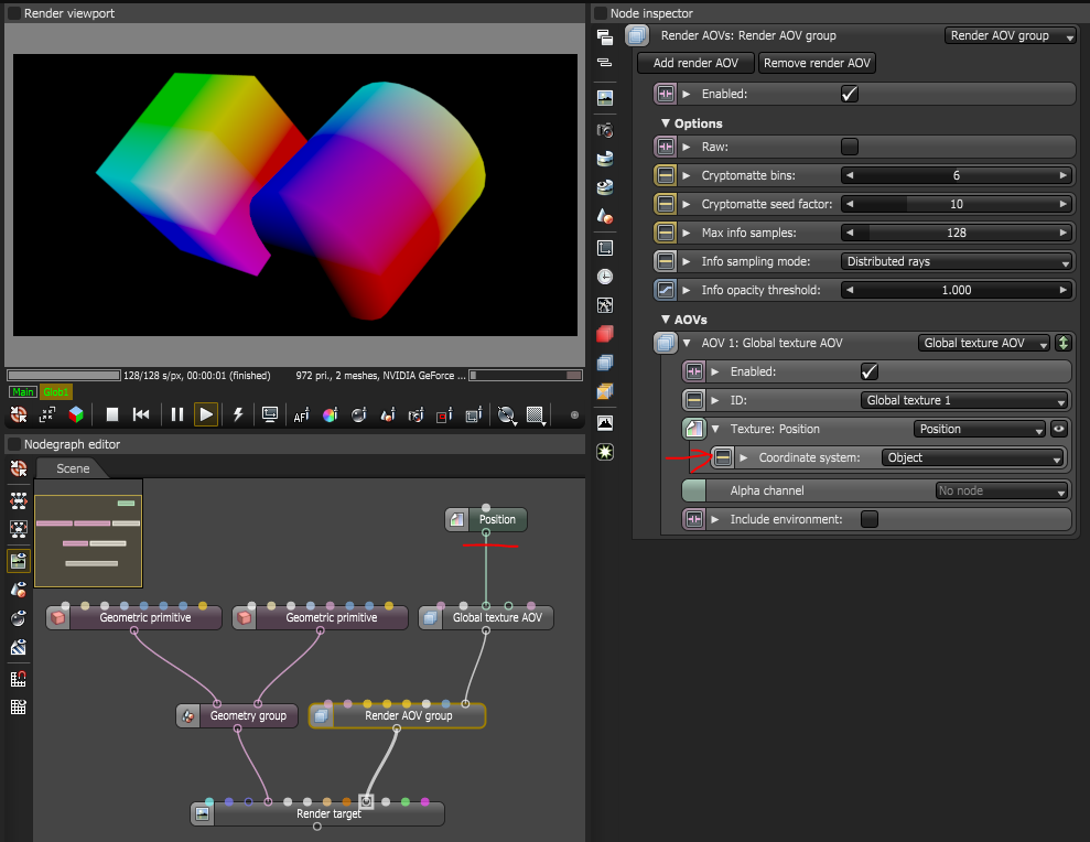

How about using a global texture AOV with a position texture set to object coordinates?
I attached a sample scene. Would this work for you?

That's crazy ! I'm using the Cinema 4D plugin & that node isn't listed in the textures group in the node editor, or anywhere in the right-click menu in the node-editor. Nor is it in the shaders list in the non-node interface either.
But when I use the search box on the node window, it's there & it works.
A position node was the 1st thing I looked for & missed it.
It looks different to the Redshift one, which is more on-off, rather than a gradient, but I wouldn't be surprised if it would work.
Thanks a lot for your help, I wonder how many more nodes are not put in the interface.
