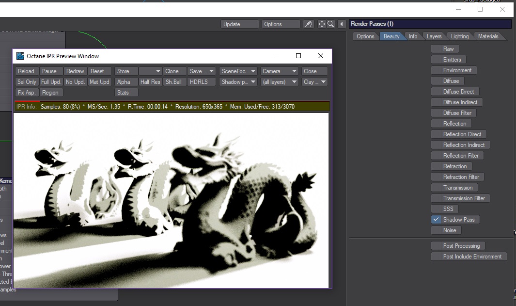

Screen might work in a pinch, but screen tends to wash out details or screw with contrast, imho. I have done this same trick, but rather used it inverted as a mask for adjustment layer (levels, curves etc).
For anyone who does not know how to get crap like this into their layer mask in PS, do the following:
Edit:
Copy > Make a new Channel (forgot this step) > Paste into Channel (if rgb, becomes gray when pasted into single channel) > CTRL+Click thumb in that channel to make a (soft) selection of white pixels > Invert selection and fill black into layer mask of adjustment layer (or any layer mask). Invert mask if needed. (or start off with solid black in mask before filling with white from selection).
*I use this method for all kinds of stuff. If there is a better/faster way to put b/w into masks, please advise. Maybe something with Quick Mask, which I never use?...
Edit:
