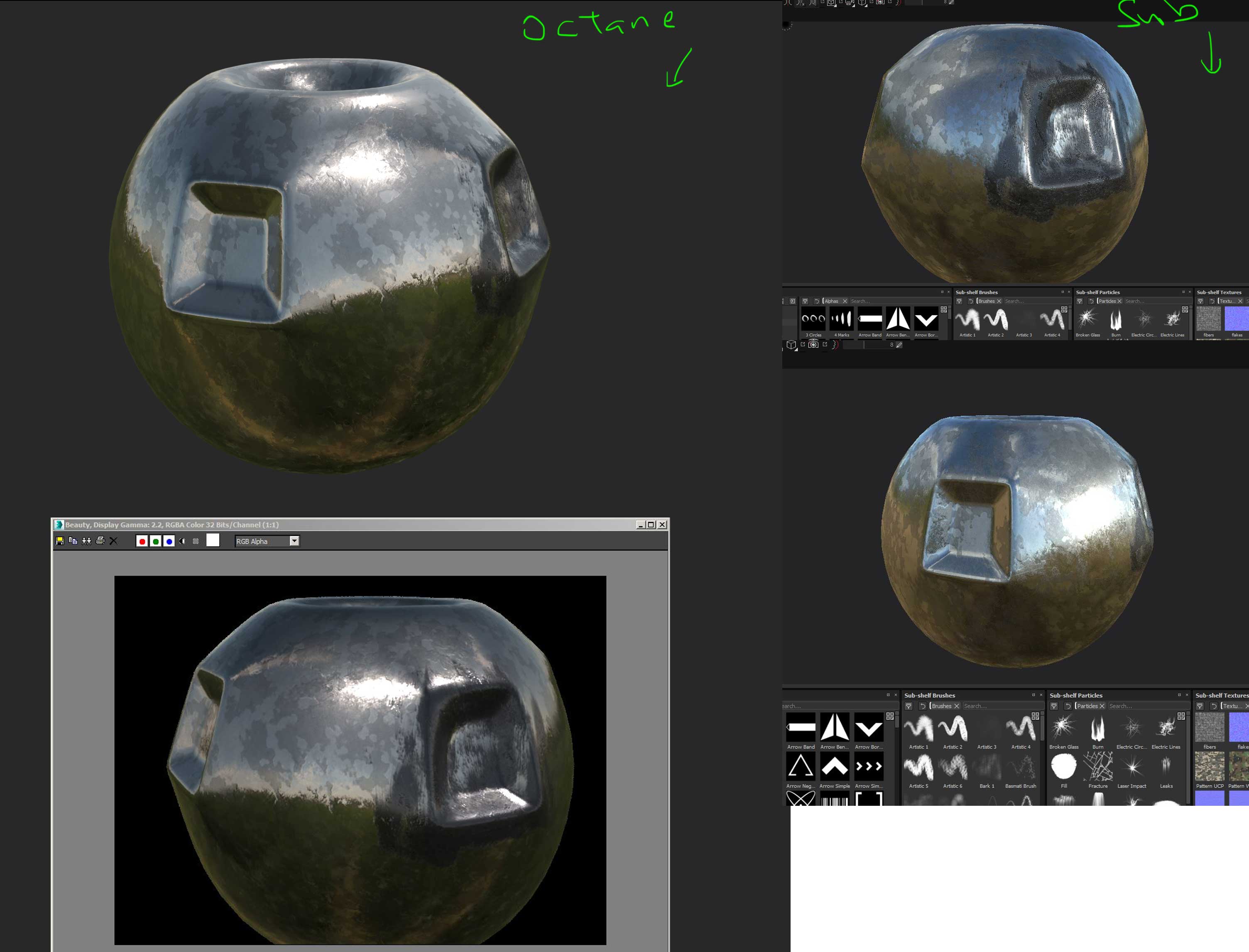

After couple of days of research finally found a detailed tutorial about substance to 3dsmax Octane workflow...

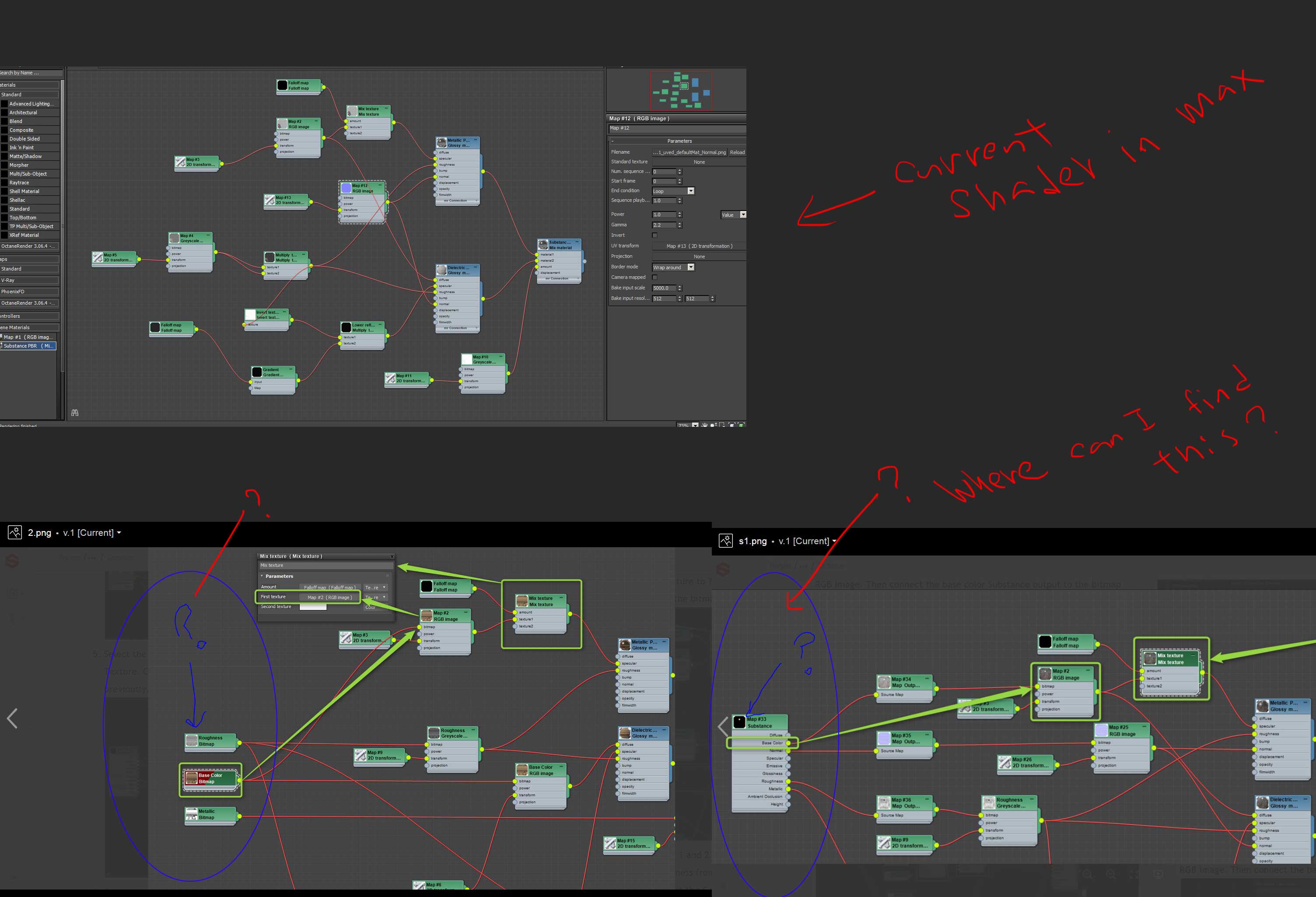

I did some test render, it got pretty close to Substance render but still missing some details, I am wondering if I missed something
during converting process, also I couldn't find the substance node inside max ( please see attached image).
If anyone knows more about it please share your knowledge thanks in advance :)

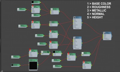

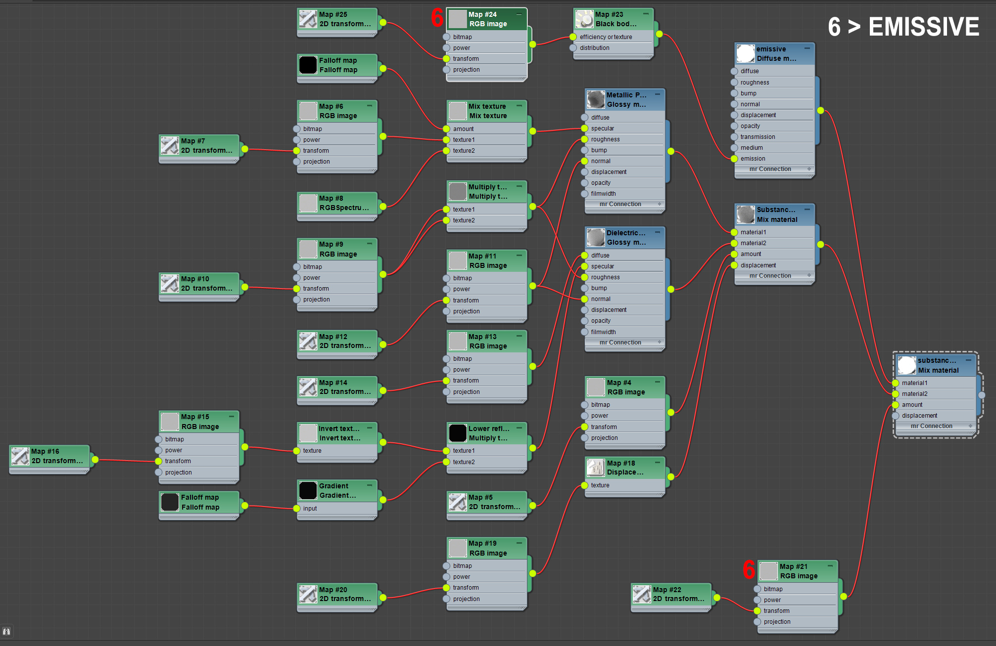

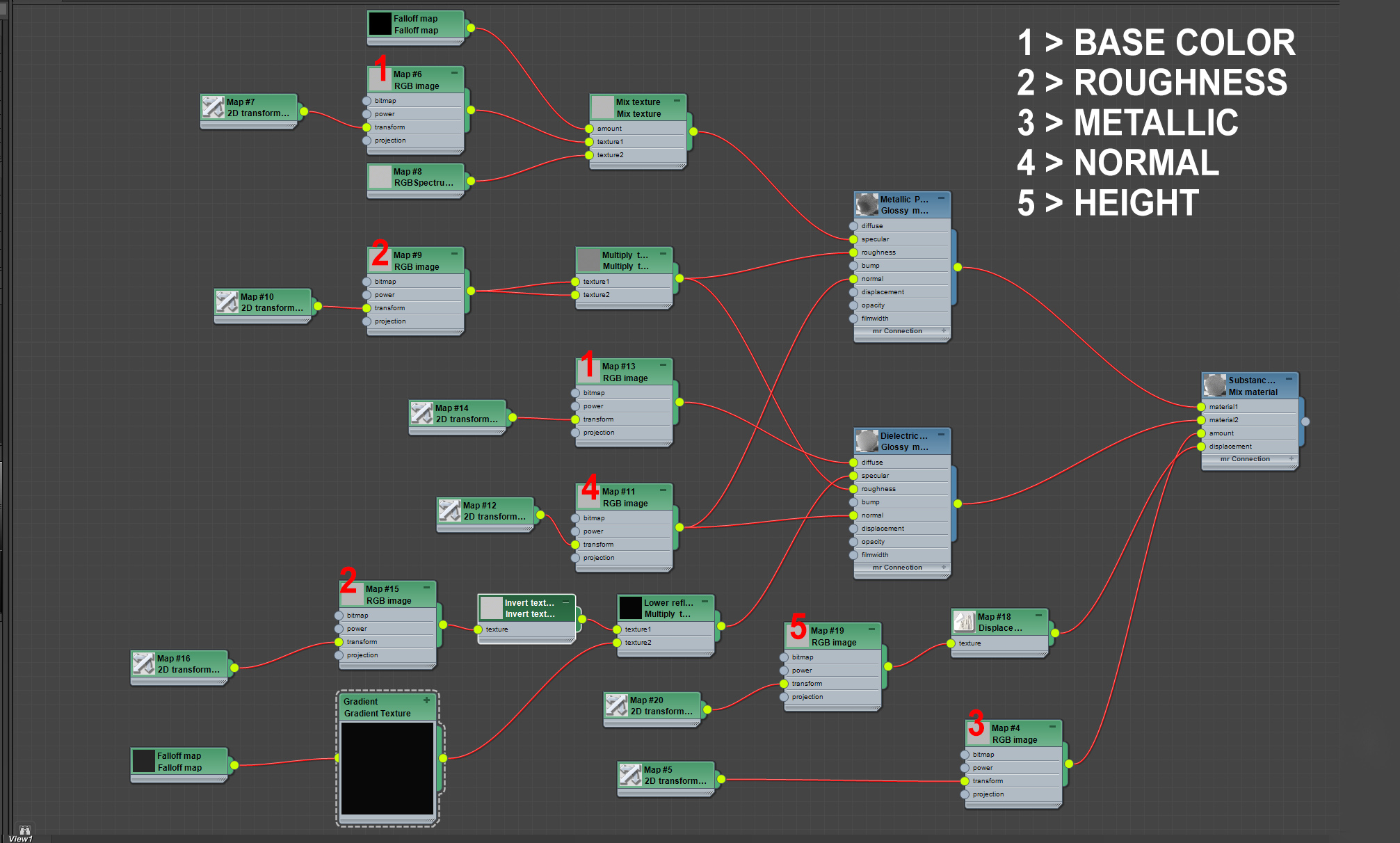

The workflow using substance PBR Octane material in LiveDB should be as follows:
I hope it can be of help to you.
Regards
Paride
PBR-max.rar
(90.47 KiB) Downloaded 227 times
