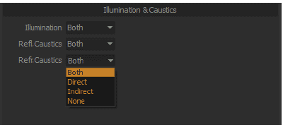

Even self proclaimed for the most "physically proper unbiased" renderer around - Maxwell Render, has this future - switching indirect/direct caustic calculations on and off for refractions and reflections along with illumination switch - indirect and direct..
Imagine how this will lower the memory footprint in some cases.
This will lower render times pretty much as well and it's nor required in most cases..
In this case - Octane Render, I think it's a must, even if the MLT core will speed things up in this area...
