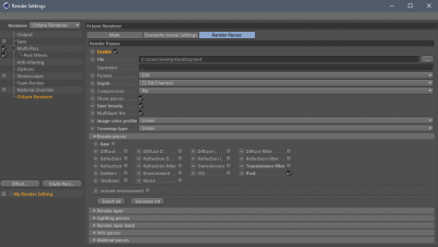

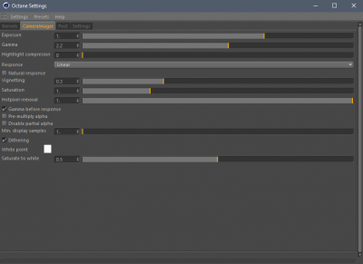

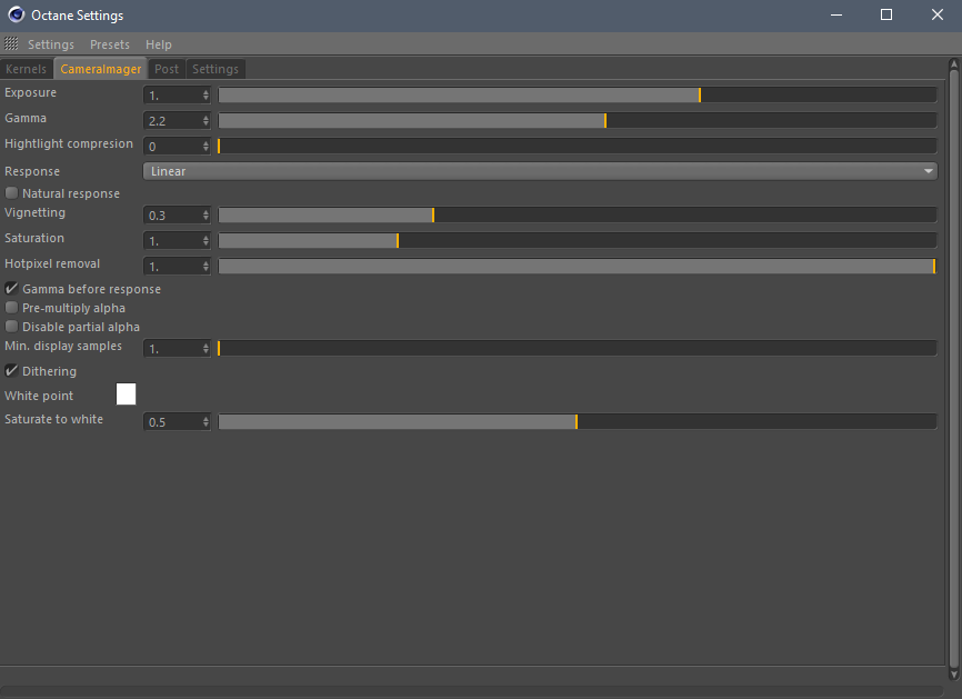

Let me add a few details in the attached screenshots.
Saturate to white doesn't render when I enable "save beauty" in the render passes.
Jeremy
Camera imager settings

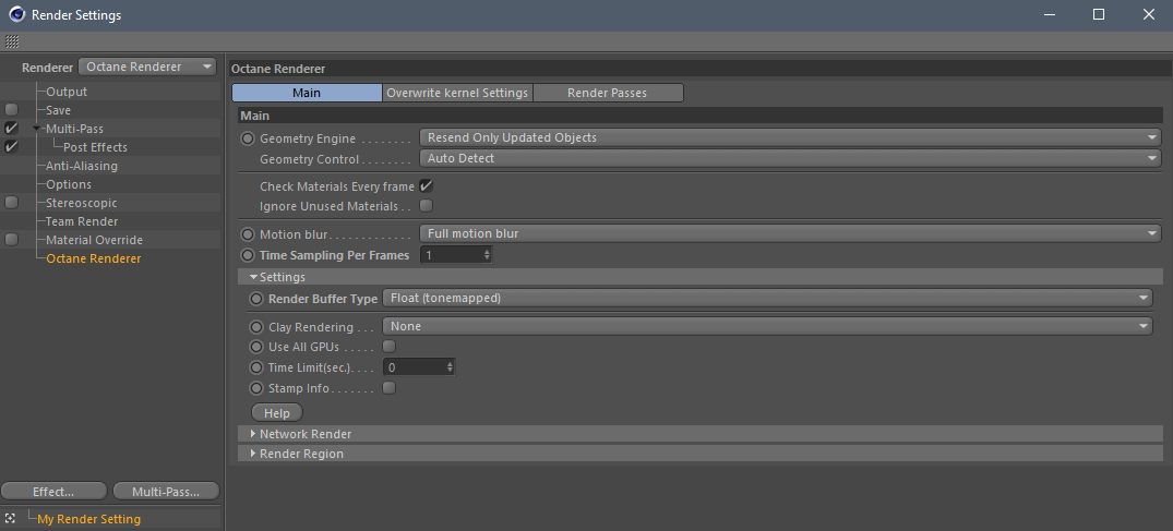

Octane main settings

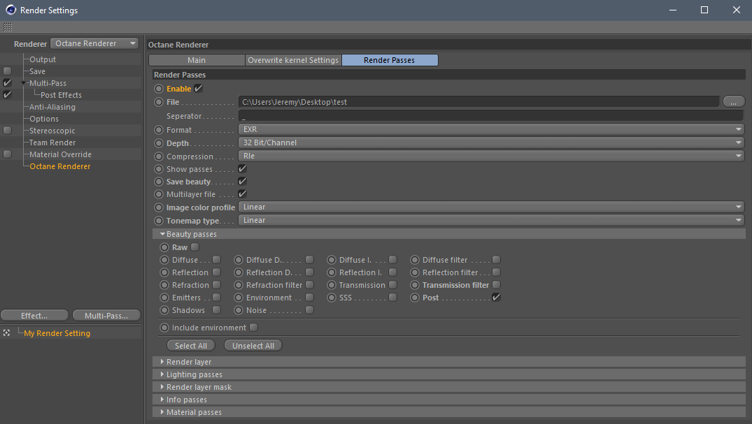

Passes settings
Passes settings

Just keep defaults in render settings and select "Render Buffer Type=Float(linear)" and don't try to match results with LV's tonemapped outputs. Change CameraImager response=Linear and gamma=2.2 to get exact results as your compositing output.

If you want you render to appear as in your Live Viewer and if you are using post effect and cameraimager settings you should set :
Render Buffer type = Float (Tonemapped) [Tonemapped actually means cameraimager...]
In your Cameraimager settings : set response to LINEAR and gamma to 2.2
If you use render passes, set everything to LINEAR in the render passes settings
Also save your beauty by the native c4d SAVE area as EXR 32bits. Don't select the "save beauty" option in render passes tab, it won't render with the cameraimager effects.
If you do so, you can work in AE / 32bpc linearized comp with your beauty and passes. Everything will look like your Live viewer.
