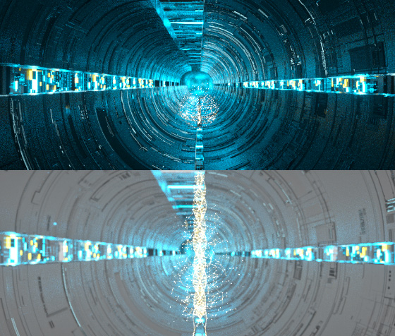

i render an exr sequenz via team on two maschines running win10 and the latest releases of c4d and octane.
the images from the master are rendering correct, images from slave render brighter.
what am i doing wrong here. double checked all rendersettings.
thx rené

this happends with all scenes i render. no one has this problem?
Hi rené,
unfortunately, team render can have this kind or similar issues, even with standard render, since all clients need to be in the same exact condition in every aspects.
Octane Network rendering is far more efficient, in my opinion.
Anyway, it seems that one client is saving in tonemapped mode, while the other in linear mode.
You can try to correct the results by modifying the Gamma to 0.454
