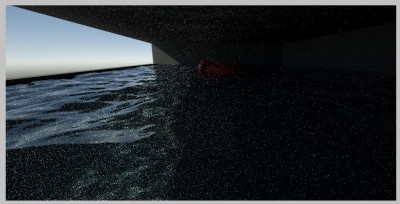

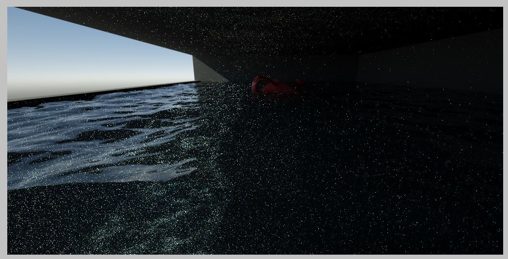

I'm playing with the OctaneCaustics scene with a new GPU and I've picked up the latest scene from the asset store. I set the kernel to both path tracing and PMC but for some reason the caustics are working but not global illumination?
I am using Unity 2017.3.0p3 and OctaneRender v1.1.0.1223.
Thanks,
John
Thanks,
John
