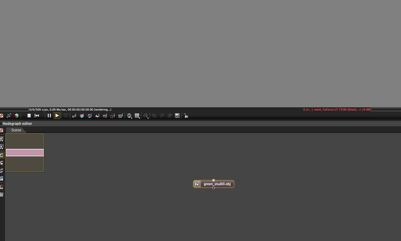

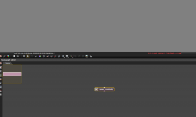

Hey Guys,
I am trying to upgrade an old license on my iMac and figured I would make sure it worked with the demo first.

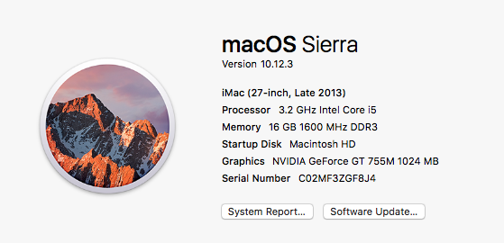

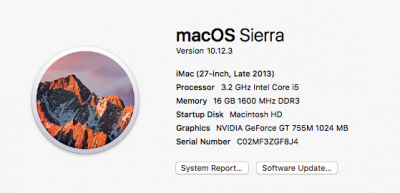

When I go to drop a .obj in and click on it, nothing happens. Click render, nothing happens. I have attached screenshots of the error I get and of my computer specs. I have downloaded an updated CUDA driver, check the NVIDIA site for more info on my card and it seems to be discontinued or something? Its a NVIDIA GT 755M 1040 and an old link I found on a forum said it supports CUDA but cant find any other info on it. I realise this card isnt optimal whatsoever but is it even possible to run Octane on my computer? Do i need to buy a new card to make it run?

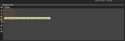

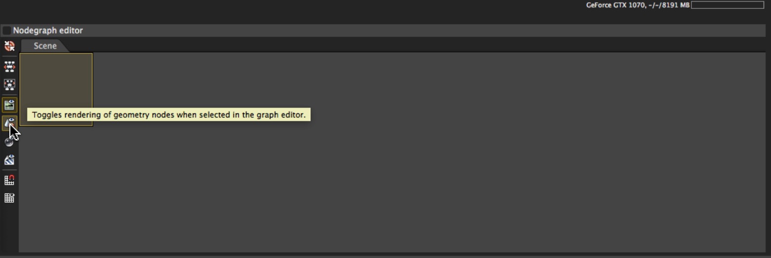

when you import a mesh node, OctaneRender does not starts to render, if the icon on the node graph is unticked:
But, since your iMac has only 1GB of VRAM, more likely, since the internal GPU is used also by system/monitor, you have not enough free VRAM to render that specific .obj node, you are limited to very simple scenes.
Do you see the red text in info-bar also at start (before importing the .obj file)?
