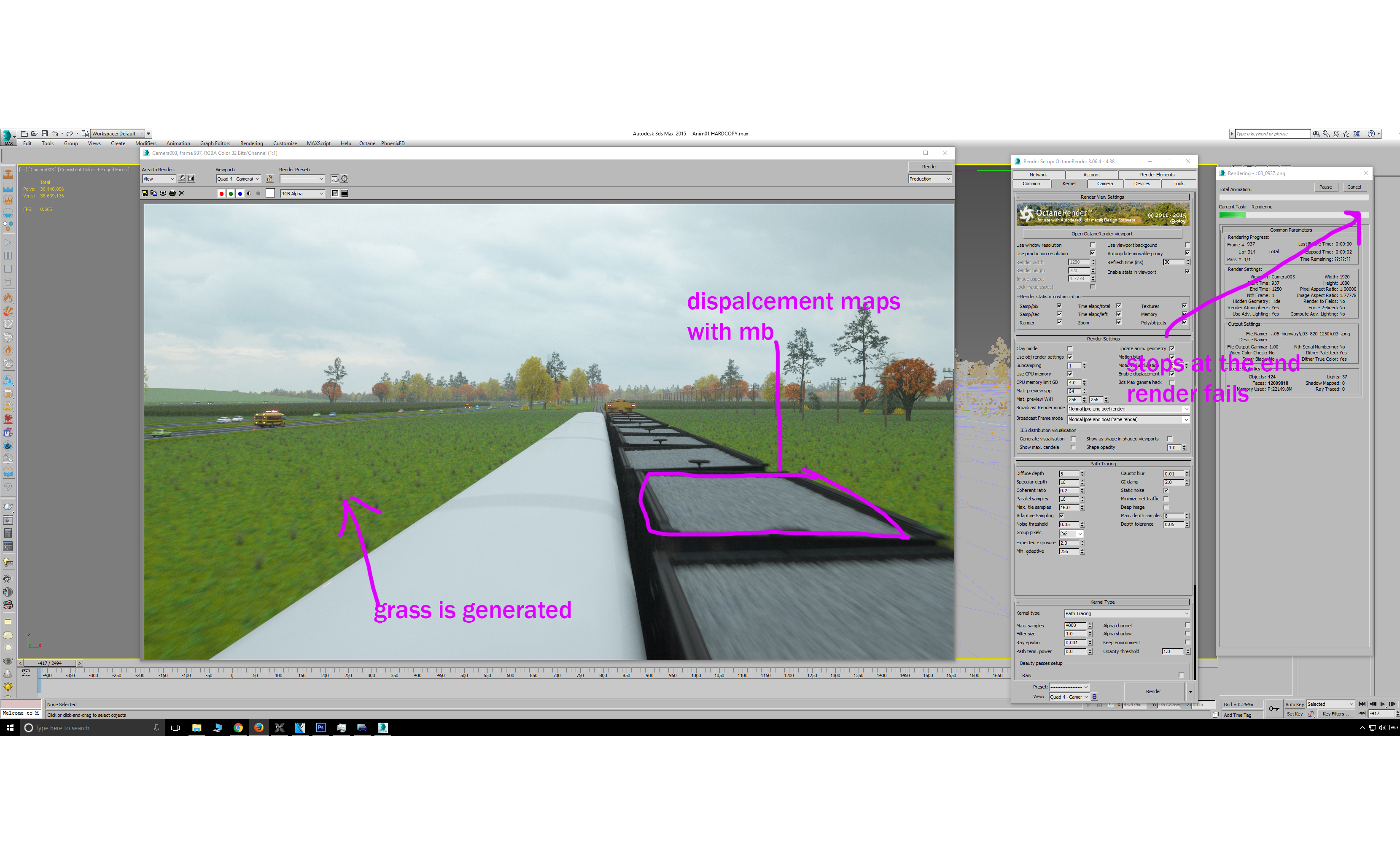

it would render 10 frames and give this erro we are using itoo forest with lots of grass that is also generated when camera moves
Also we have this train pass hauling rocks as displacement map? Can this be the reason Or are we running out of vram

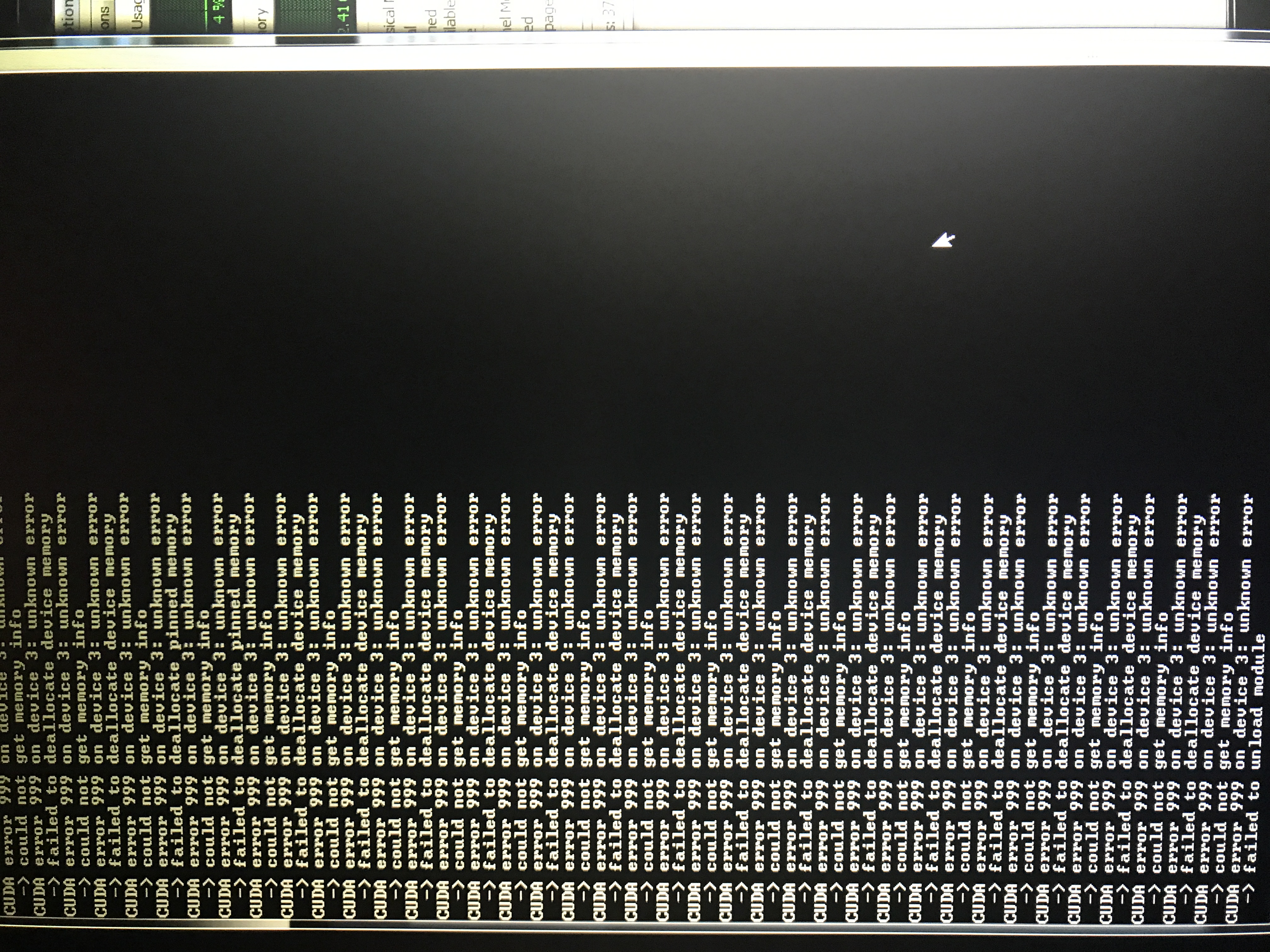

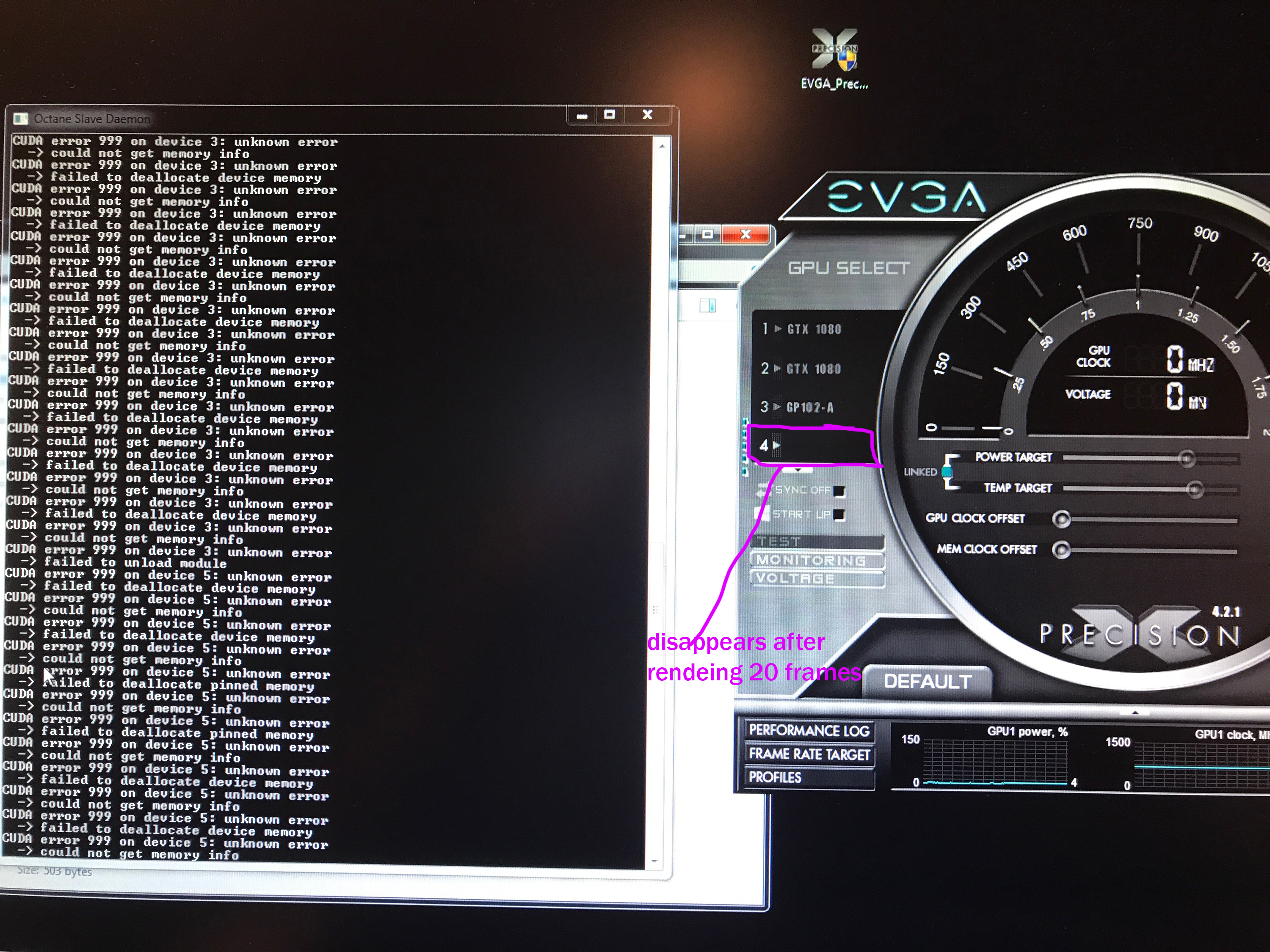

ok after some tests it looks like one of the slave crashes with the following error as well making rendering stop
cuda 999 could not get memory info and one of the GPus disappears from evga precision. But that GPU works greate rendering other scenes so it is not bad GPU I guess .

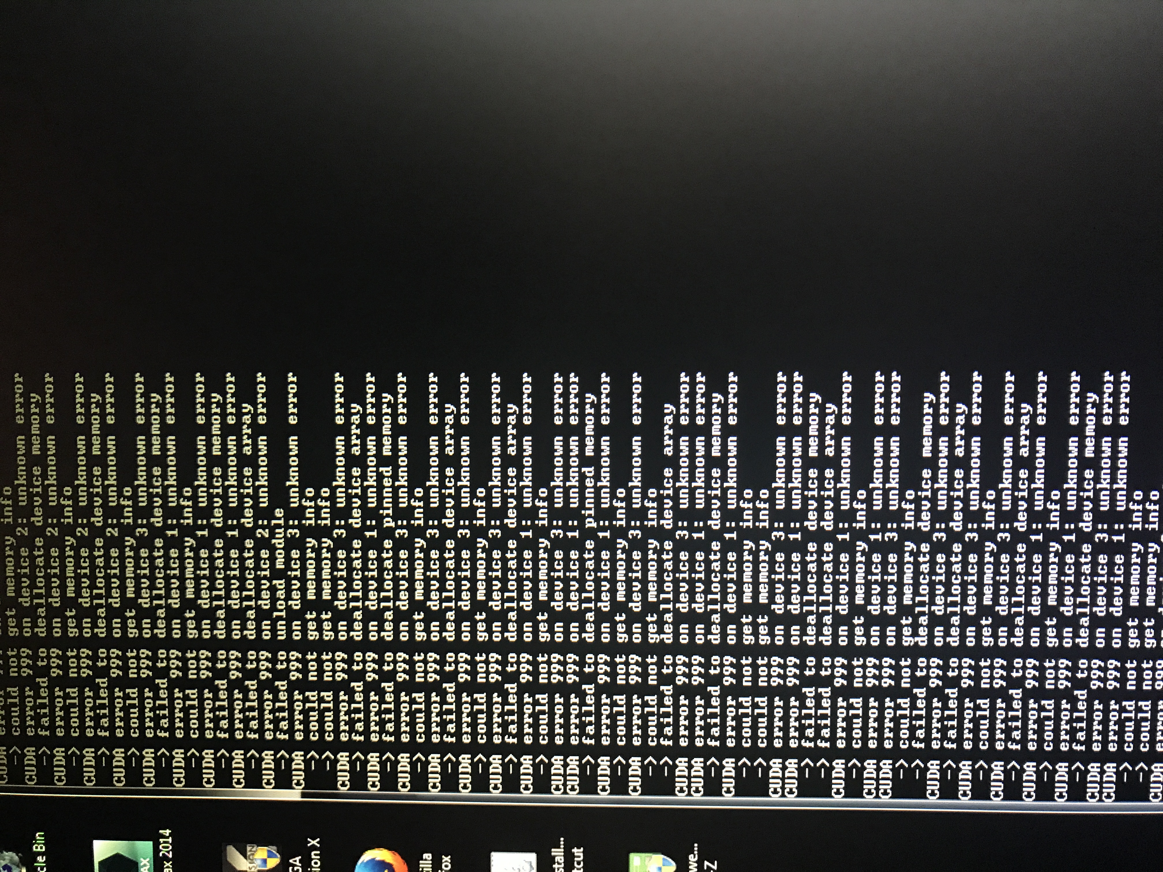

Another slave just gave me an error Cuda context was not destroyed
Seems like all these errors above happen after 10 frames of rendering. Also railroad rocks is a displacement map
