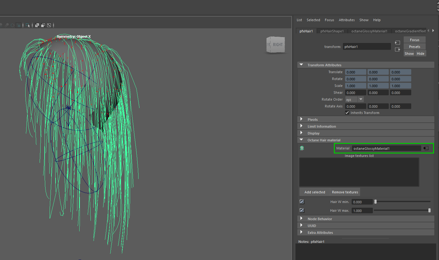

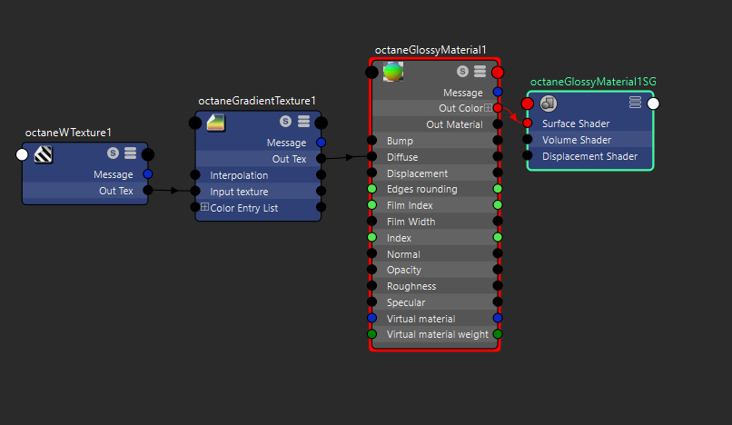

The W Coordinate texture was added in v3 plugin. We are still working on the Maya user manual, hoping to upload after the refactoring is complete.
However, It is very simple and works exactly as Standalone.
Please refer the file attached and let us know how it goes.

Basic usage of the w-texture node is possible in the V3 plugin (as in Bikram example), but the implementation is still very WIP,blackshore wrote: Accourding to Status:
viewtopic.php?f=28&t=61075&hilit=calus
The W coordinate texture is broken or incorrectly implemented?
new parameters have been added on the pfx shape and pfx transform but they are broken
So for advanced hair texturing (using U , V and W coordinate) this is not possible,
As you may have noticed, for some reason, useful hair UV have never been implemented in the plugin,
so the only way to assign an UV texture to hair is trough the Maya Hair shading system (baking Maya colors in a dummy empty octane texture node),
but in the V3 plugin, Maya colors are still not interpolated along W ... not sure if the state is "half-implemented", or just "broken/unusable".
