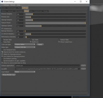

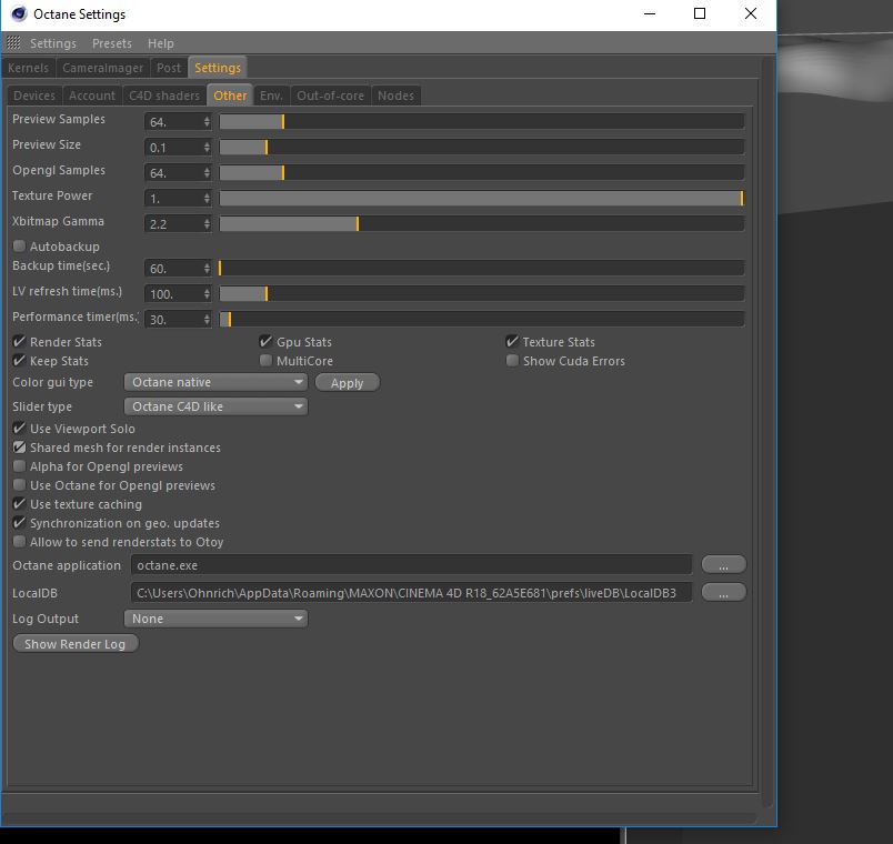

Do I have to change something in these settings? But what?
Everything I tried so far did not solve my problem.

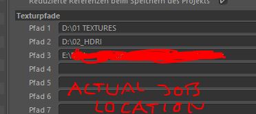

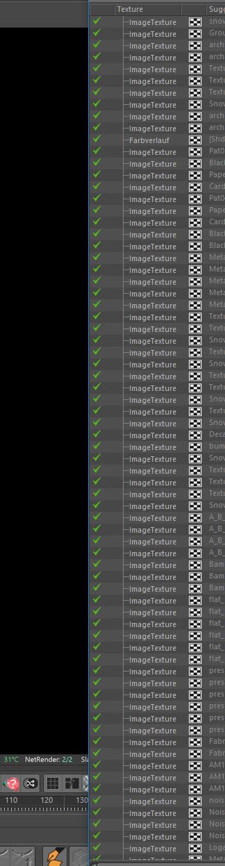

Texturemanager gives no errors
Texture Paths are set in pres
