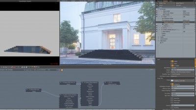

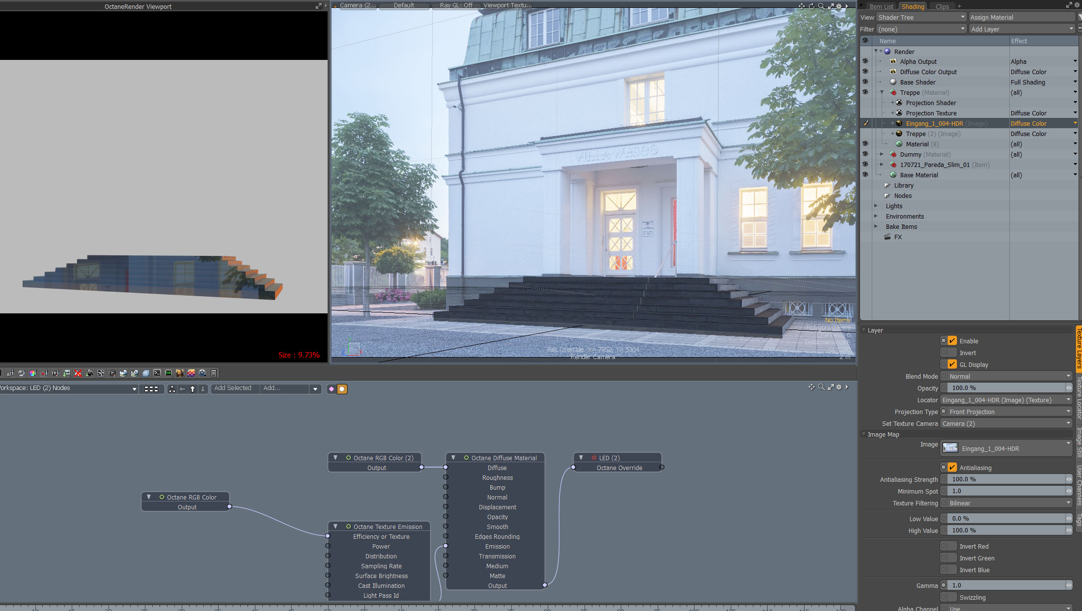

i have to line up a Image which was taken with a tilt shift lens. I want to cameraproject the image on geometry but it doesn't fit in Octane. In Modo it works nicely.
Can you fix this? Thank you in advance
face_off
Posts: 15761
Location: Adelaide, Australia
Hi - I doubt the Front Projection support takes into account the camera lens shift. Are you able to send me a scene which demonstrates the problem you are having pls?
