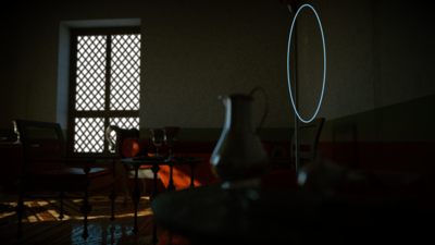

Hi I have a problem. In the render are artifacts.
How I can fix it?
Thank you very much

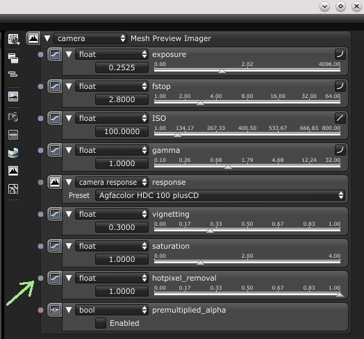

These are fireflies, comming from very glossy materials. Every unibased renderer has this.
Google for fireflies and mlt.
Reduce it with hotpixel_removal at Mesh Preview Imager.

I have it at 0.

Oh, try to reduce the spec on the floor.
I think it is better to post this on the commercial support form to get more advanced help.
