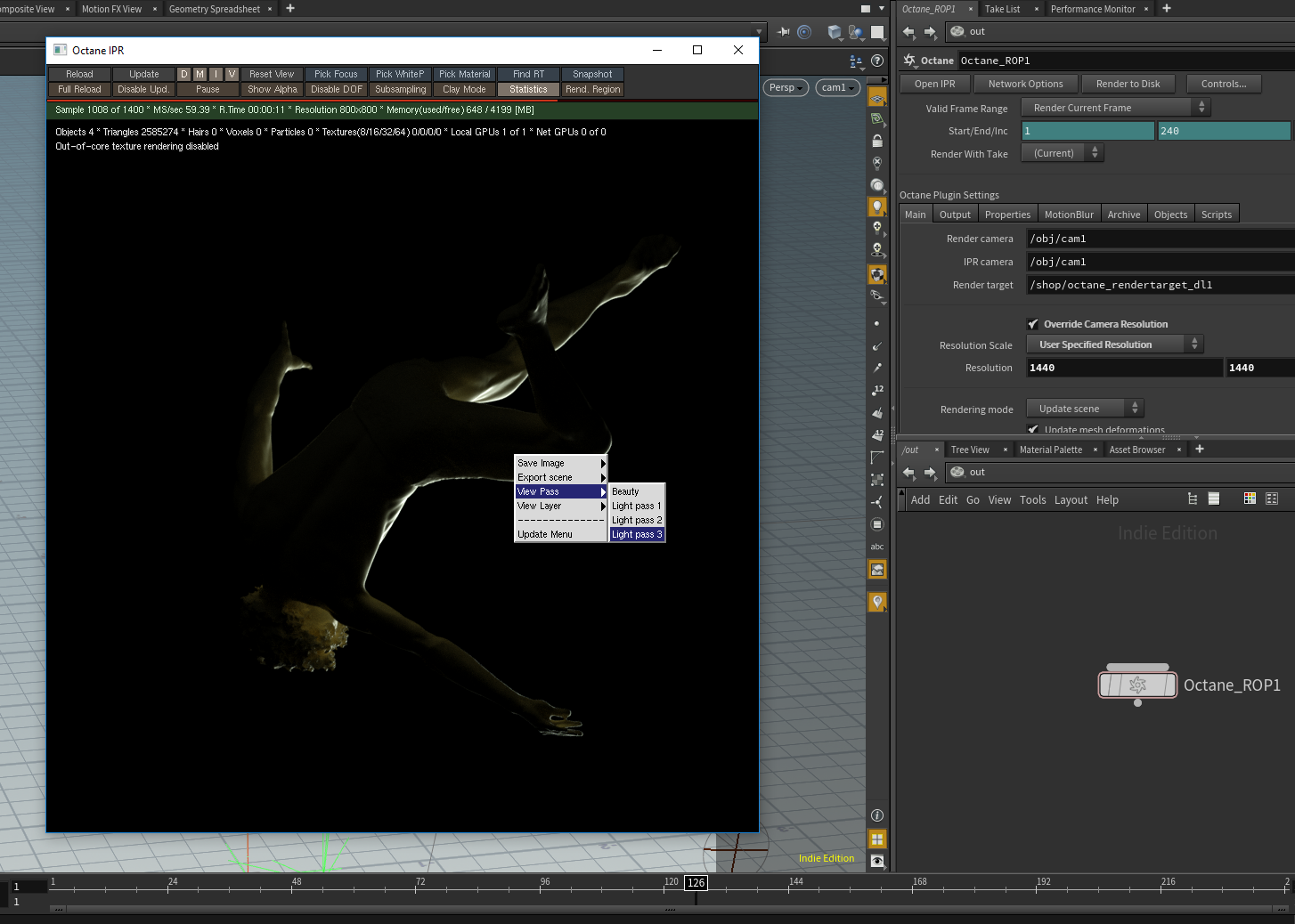

I am pretty sure I have everything setup correctly with the light ID (1-3) on the lights themsevles. The light passes show up and look correct in IPR (the right-click>View Pass):

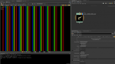

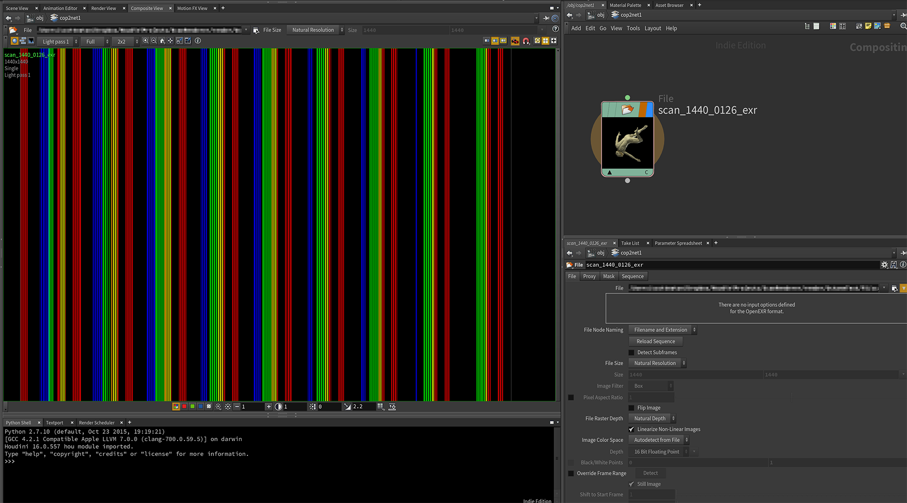

But when they are saved to disk as multicannel EXR and loaded in, they are broken - just a couple randomly colored vertical stripes going through the channel. I am reading the EXRs back in via COPs and this is what on of the light passes looks like (attached):
Beauty, Alpha, and Z-depth channels look fine.

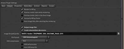

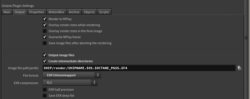

Not sure how to save light passes to individual files.
I have three light passes enabled, and Output Image Files check in the Octane ROP. I tried setting the file format to "EXR untonemapped" and also "PNG tonemapped" (instead of multilayer EXR) and strangely, it renders one image per frame but that image is the 3rd lightpass, not the beauty.

It is really a weird issue. I can reproduce this problem here, but the multilayered EXR file seems broken only for the Houdini COPs. The same file works fine for example in Fusion, without problems with the light passes. Are you going to work with Houdini also for compositing, or are you going to use Fusion, AE or Nuke?
If you write the passes to individual files, all seems to work fine. The light passes can be read by the Houdini COPs without problems. Be aware that to write the individual passes files, you must use the $OCTANE_PASS variable in the filename to add the pass string to the file and don't overwrite all the passes using the same filename.

Bumping this thread two years later. This still seems to be broken in Octane 2019 and Houdini 18.
Lightpasses (and some of the info channels) rendered out of Octane into a mulitlayer EXR are black in Houdini COPS. They load fine in other compositing app.

I've just been in touch with SideFx and the problem in COPS seems to be related to the spaces in the channel filenames, i.e. "Light Pass 1". It is not handling the import correctly because of this. This explains why 'Z-depth' works, but 'Shading Normal' or "Light Pass 1" doesn't. They've filed a bug report.
