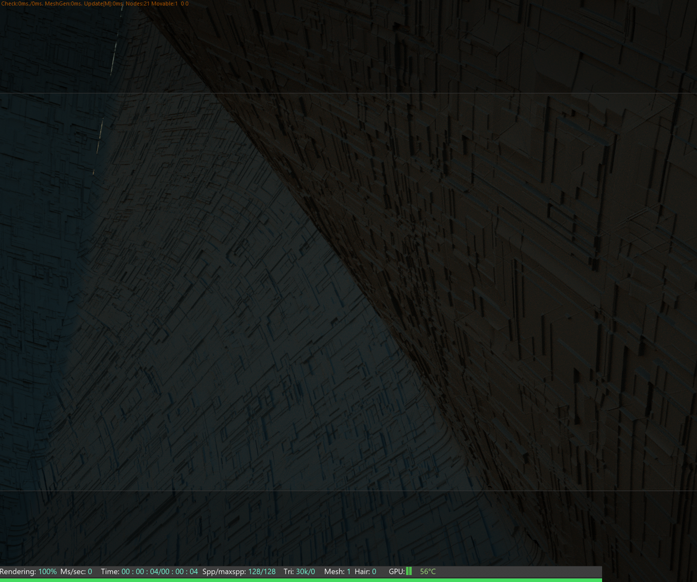

Edit: another little issue: how can I get rid of the seems showing in the screenshot? midlevel is already at 0.5
6850k // 32 GB // 1080, 1080 Ti, 2080 Ti // Win 10 // C4D 19.068
Nuji
Posts: 5
Joined: Wed Jan 11, 2017 3:55 pm
Only thing I can think of is unchecking "Angle Limit" in the Phong Tag.
