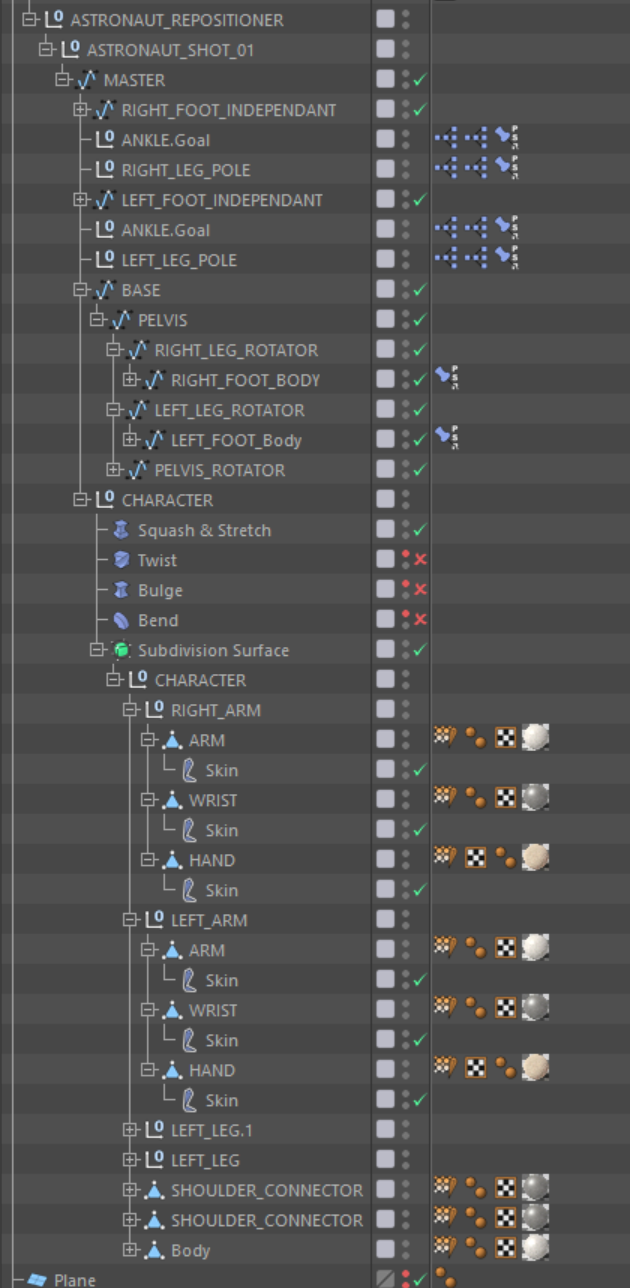

I've attached my first render attempt so you can see, also a screenshot of the character structure in my project.
It seems to only be a problem when I'm rendering with Octane (I've been doing software preview renders all along with the cinema renderer and haven't had the issue until I switched to rendering with octane for the final output).
The only things I can think might possibly be affecting it is the fact that I've got a squash and stretch deformer acting on the mesh, and maybe it's order in the object heirarchy is messing up the mesh calculation at render time.

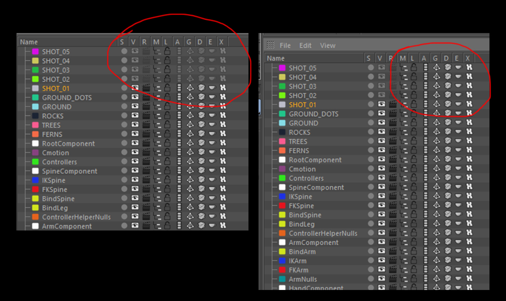

I tried changing a few more things around in the scene and did some more low sample renders, and I think I've figured out what is causing the issue:
I've used the c4d advanced biped character object to rig the astronaut. I then duplicated it for each of the shots in my animation (which is probably bad practice, I don't do much character animation, I was afraid it would get really messy if I tried animating all the shots with the one rig).
Then for each of my shots, I added them to a separate layer, so I could switch them on and off to optimise the scene as I'm working.
I think the problem is that when you use cinema 4Ds character creator, it adds all the separate components to its own layer system. So when I've added the duplicated character rigs to new layers, I've messed something up in the advanced bipeds layer structure.
After doing a few more test renders, it seems that if I turn all the layer switches for the other layers off, except the shot I'm rendering (the left side of the below image), it causes the random bound mesh lags throughout the render.
But if I make sure that all the layer switches are on for the other shots, except visibility and render, I don't get any mesh lags (right side of the below image)

Thanks for detailed investigation. I'll try to understand the issue on next days.
