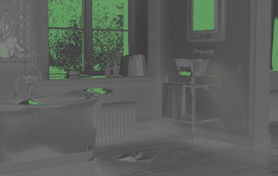

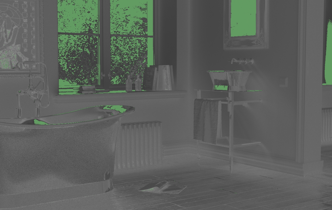

Hi, I hate to rise such an issue again but I'm getting curious on why my image can't get cleaner despite a good 16000 samples throw in + I'm noticing some jagged edges on one of my model but a render close up does not show such issue( the model is fine on every other render made with it )
1) Image A 8000 noise map is what I get cleaned up although it looks to me there is still noise around, maybe I'm not optimizing the material that I'm using for the wall or I can't say..

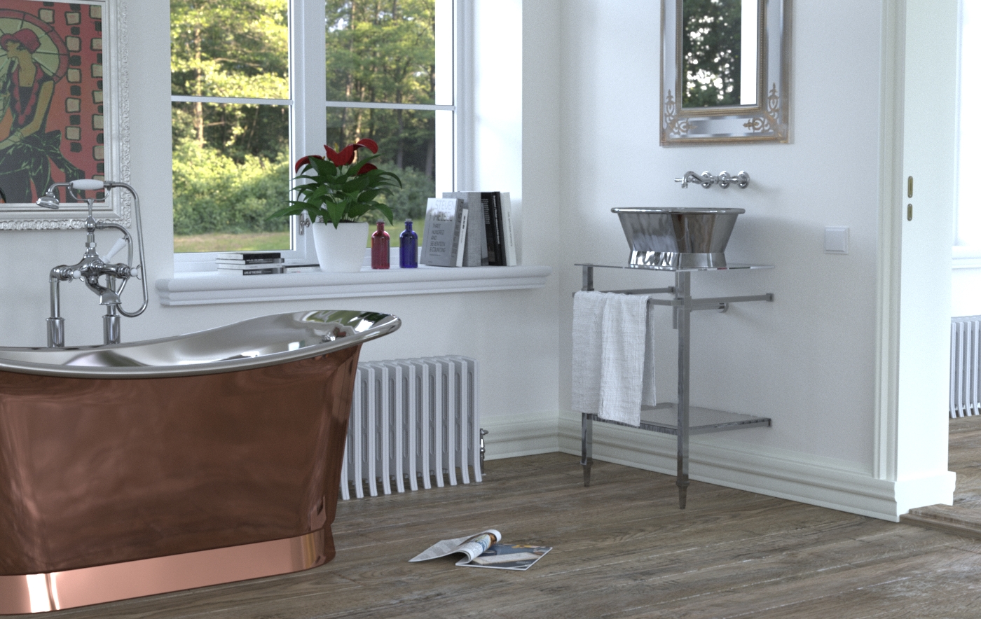

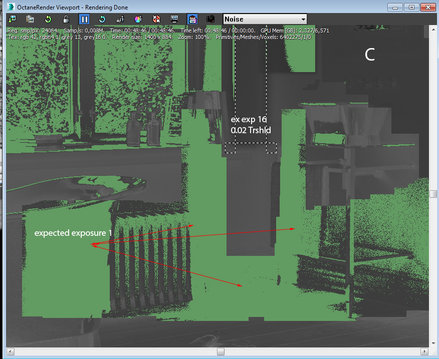

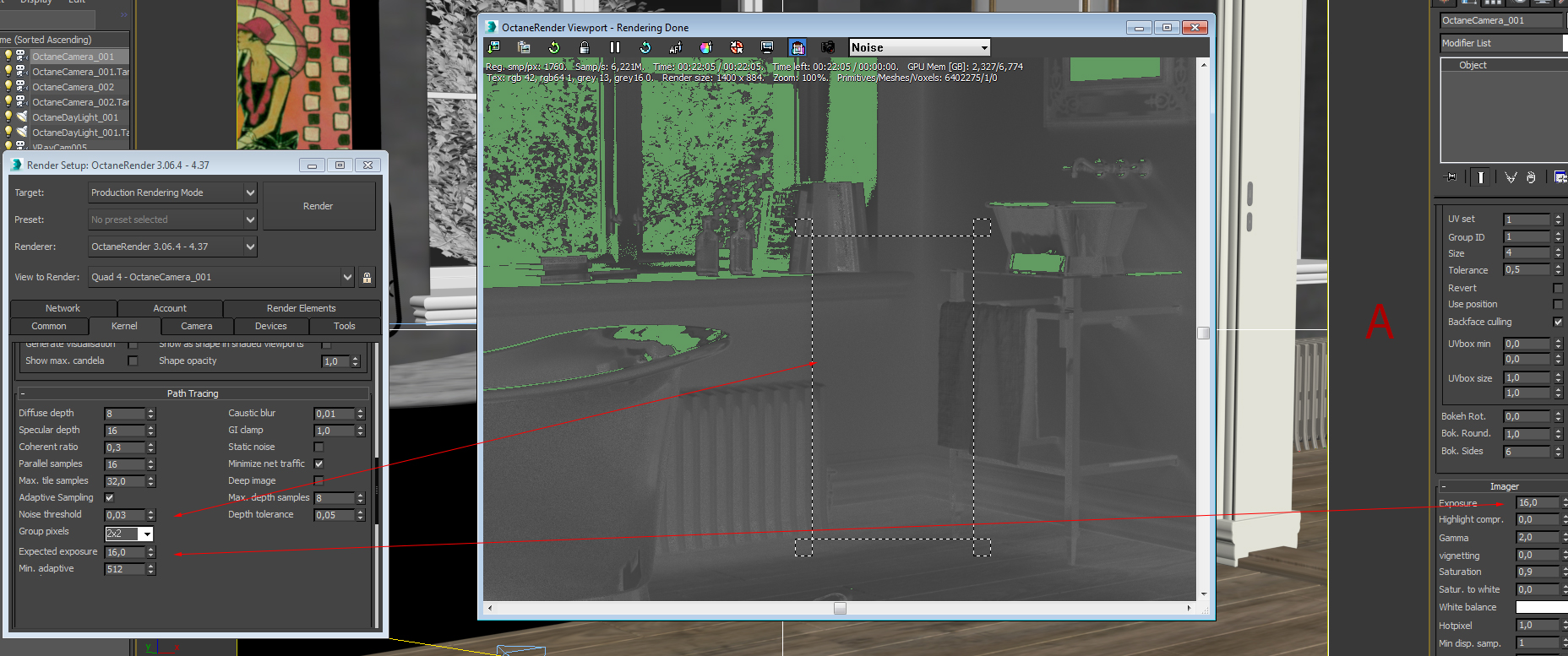

in Figure C I lowered the exposre testing it with a region render BUT as soon as I use an exposre equal to 1 it start detecting noise BUT no differences really.. but If I lower the treshold to 0.02 keeping the exposre as my camera setting it just does not pick up any noise left..or so after like 10 min of region and that it seems to me a lot. see the region opened and no noise is detected but the area in the render looks like it still need it..

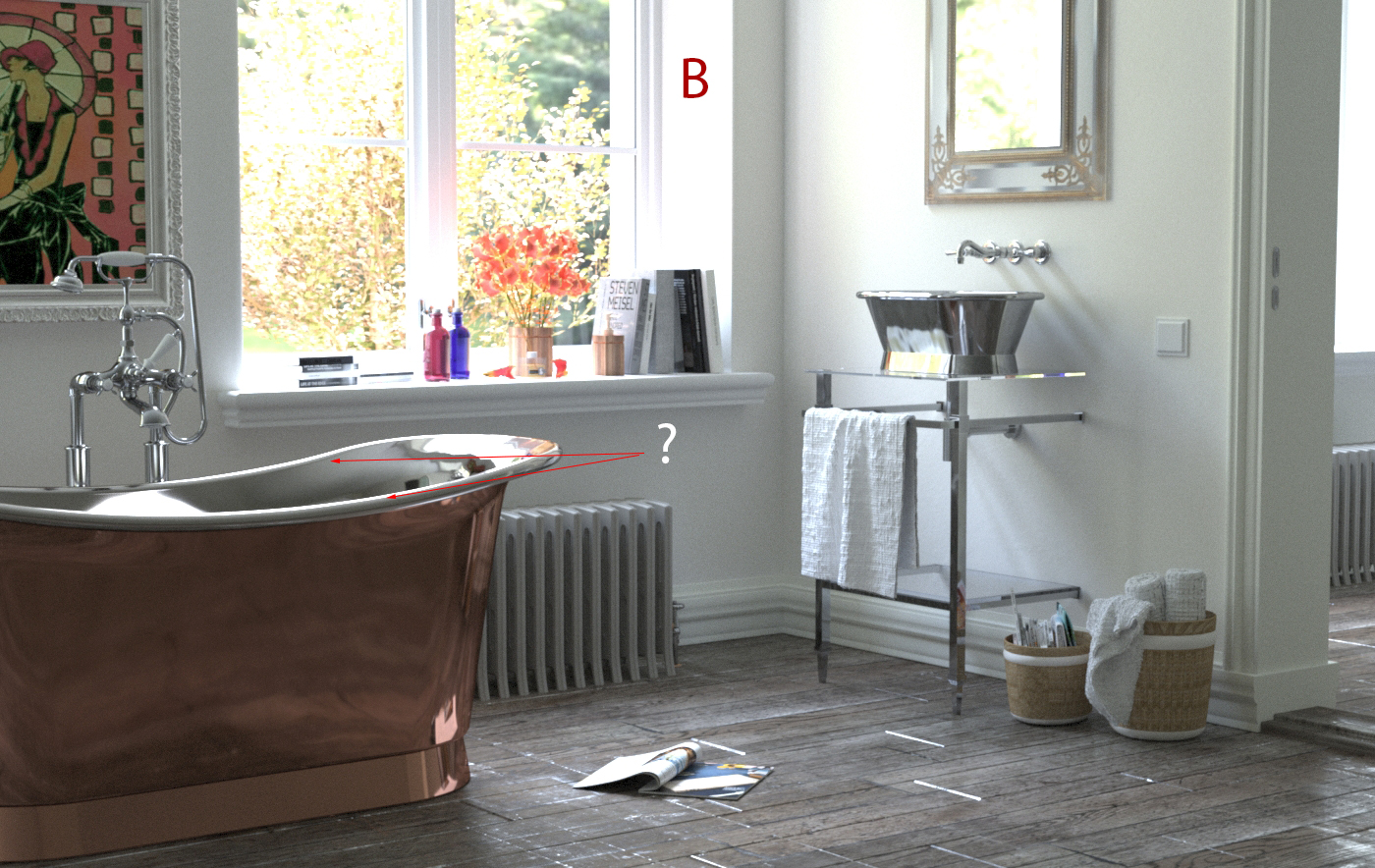

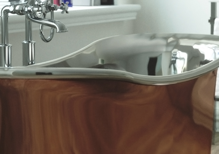

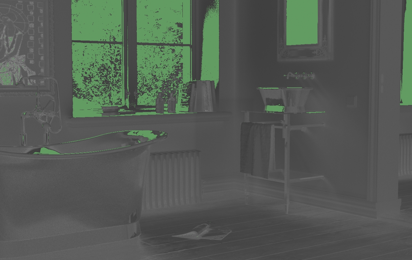

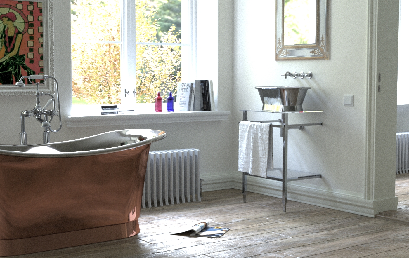

Final a 16000 samples shot were it looks just slightly clearer but the noise map was not better than the 8000 ( sorry I added up few objects ) ALSO I notice some jagged edges on the bathtube not visible on a close up (??) what that could be?

Hi justix,
Difficult to say without having the scene.
I can say some rules maybe that'll do the tricks.
Reduce Specular in materials when it is possible (walls, for example) and avoid using Roughness 0.
Do not use specular material for windows, (you could hide the glasses), but if you need glass, use a glossy material, edit IOR and falloff skew factor in falloff map into opacity.
Leaves openings behind the camera.
Normal maps and even displacement can generate noise, be careful about quality and if you could replace it with bump map.
Do not add color correction, projection, and tranform node in hdr map using Texture Environment.

I should check for ray epsilon maybe? for the jagged lines on the bath edge

About the rayepsilon, you might try, but check it, may depend on the scale unit also. It could depend on by front light that makes flatten the objects.
If you have holes behind the camera, always keep them at the window height, to give natural light to the light and as mentioned above, avoid direct light; rays must "go out" not "enter"..
Something weird looks like the bathtub, it looks like a lowpoly, most probably needs an unwrup; reflection does not seem to follow the tub shape but geometry.

It depends on the secene as you know theyr are all different and the room feeling is a priority, the bathtube is a Step file so very high poly but sadly the unwrap bit is not a friend of mine, I MUST master that side of the handling with 3DMAX especially mapping a bent tube although No machinery ever brushed on a finished product such as tube tap, it's bent after the finish is applied to it.

Hi Justix,
If light comes in this is good, but I talk about light coming out because with adaptive sampling, it might be preferable to increase samples and reduce ray baunces,
reducing calculation and noise.
By adjusting the noise threshold, gains more. Even 0.05 may be good.
