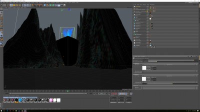

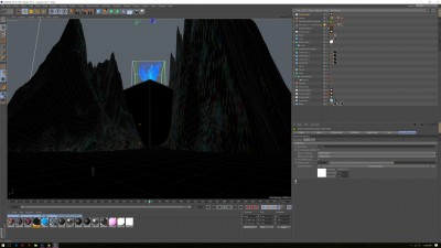

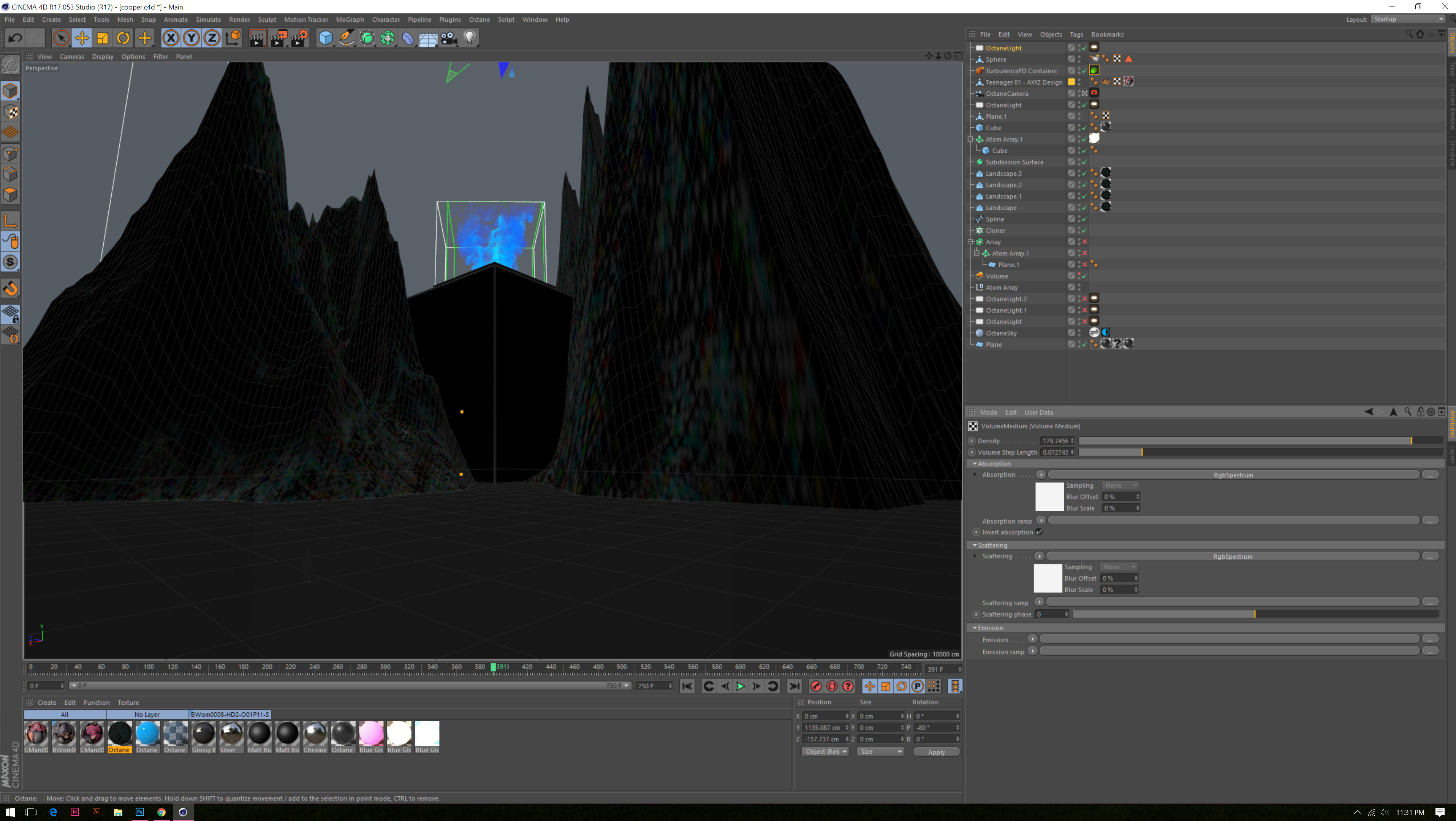

Hi guys i'm about to lose it with this plugin - keep getting issues being able to see the smoke - can someone help me out with my settings or let me know what im doing wrong here?
Weird thing is is that this usually happens when i create my scene then after i add in my turbFD smoke... any ideas? Some SS below:
Another note... its intermittent - if i tweak around with the settings long enough i can get something to show up. I'm guessing something is not matching between my TFD settings and Octane Medium.
Thanks.
Posts: 10516

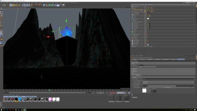

Hi hoice,
you have set both channels to temperature, while your medium has no emitter node. Try to switch to density for absorption/scattering.
Then create the Texture emission node and the Volume Gradient node in the emisdion rampe pin.

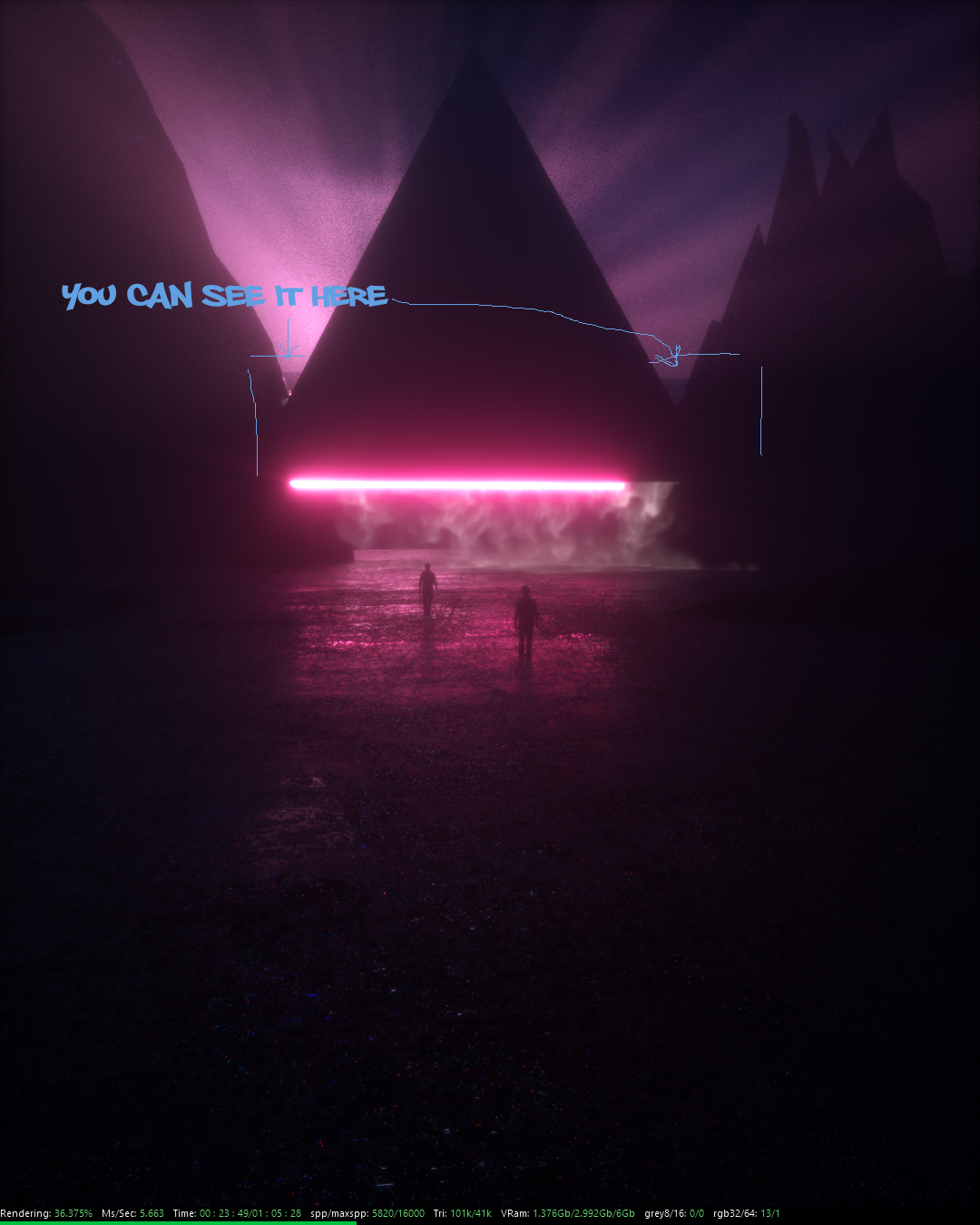

Folks one last question (i hope)... when I place an Octane Volume in with fog then use Turbulence FD i sometimes see the TurbFD container shape around the fog.
How can i hide this or make it blend in more with the background?
