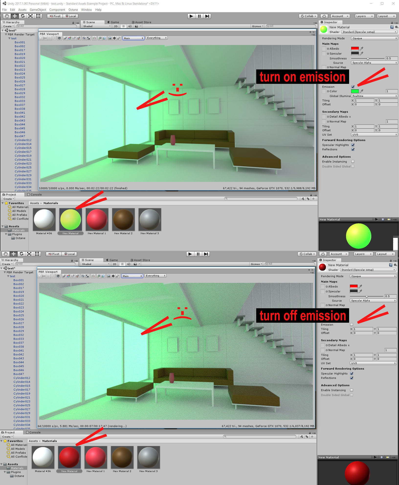

shaders turn on but does not turn off emissions.

paride4331
Posts: 4004
turning on but does not turning off emissions.

This is a separate material property in Unity, which is not contained in the shader, causing us to miss it. We'll try to add it to our upcoming Unity → Octane material mapping fixes.
- Rick
