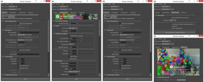

Hi Everyone, I have a problem with octane render in Maya. I can batch render animated scenes in Maya 2017 with Octane but i could not render same scene (same render settings.) in Maya 2015. How do i solve this problem...? Thank you...
You can find Render Settings in attachment.
Maya 2015 SP5
Octane version 3.06.4 - 11.7
My scene : only basic cube and hdr for light
Maya Render Log : Fatal Erro// Maya exited with status -1073741819
