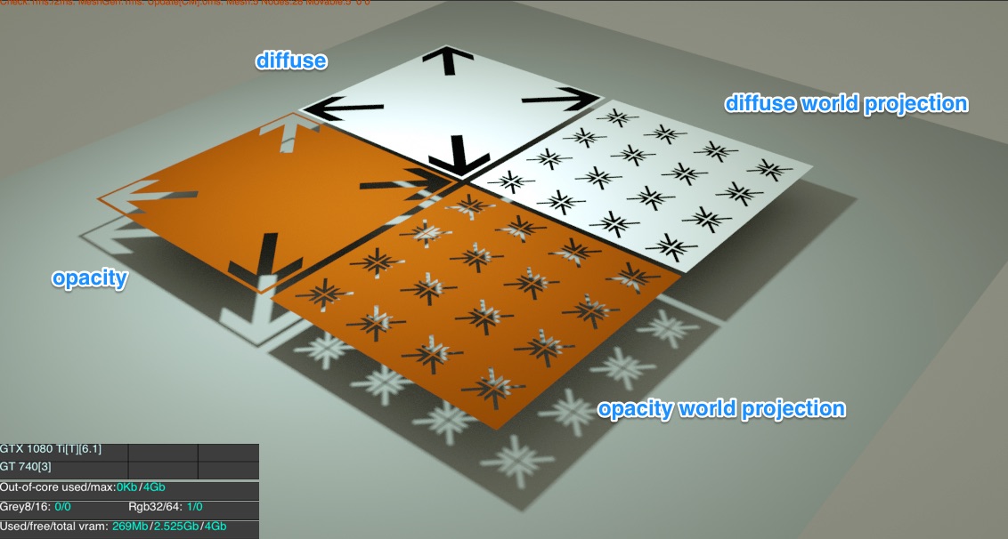

niestudio
Posts: 265
Joined: Fri Aug 21, 2015 10:03 pm
I'm not seeing any discrepancy on when I test a basic scene.
Do you see the same results if you load this file?
Can you post a simplified version of yours or some screenshots?
diffuse_vs_opacity_01.zip
(116.98 KiB) Downloaded 153 times

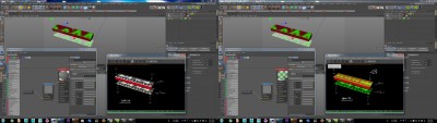

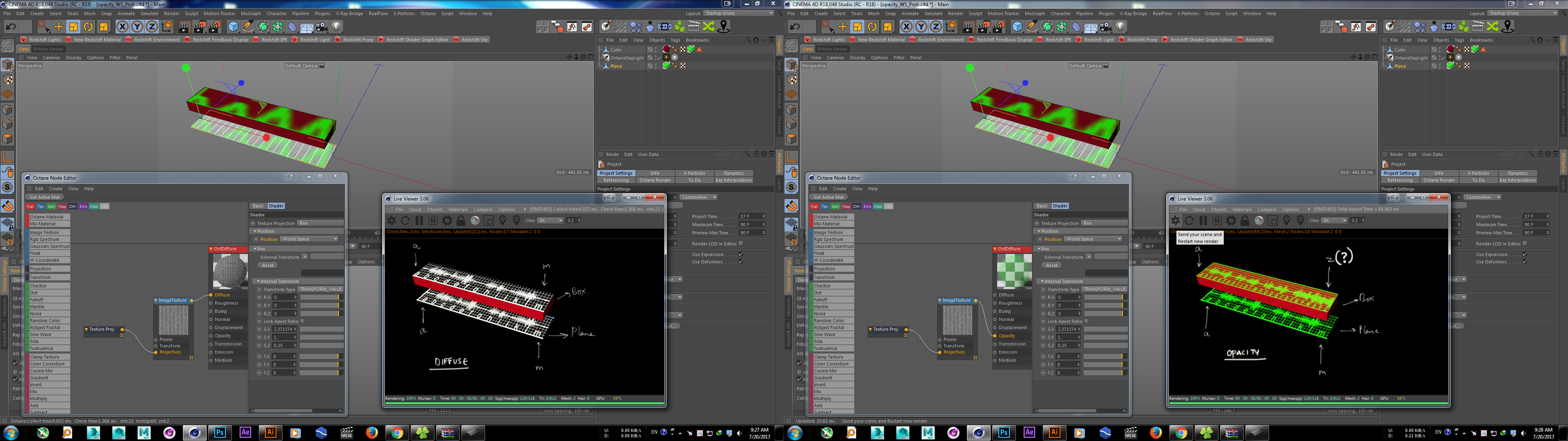

Hi everyone,
Thank you for your replies and test scene file and sorry for late response since I got very sick.
I now think there are some problem with my setup or something else. Please check my scene files attached. So far, it's behaving correctly in the plane but it's giving problem with a cube.
Attached is a screenshot too.
screenshot
screenshot

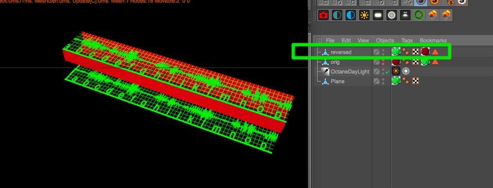

niestudio
Posts: 265
I don't know how to track down the root cause, but it seems to me to be related to the selection tag.
if you invert it i.e. apply your transparent material to the whole object, and then select the sides / bottom, and apply your diffuse material to that, you get the results I think you're looking for.
