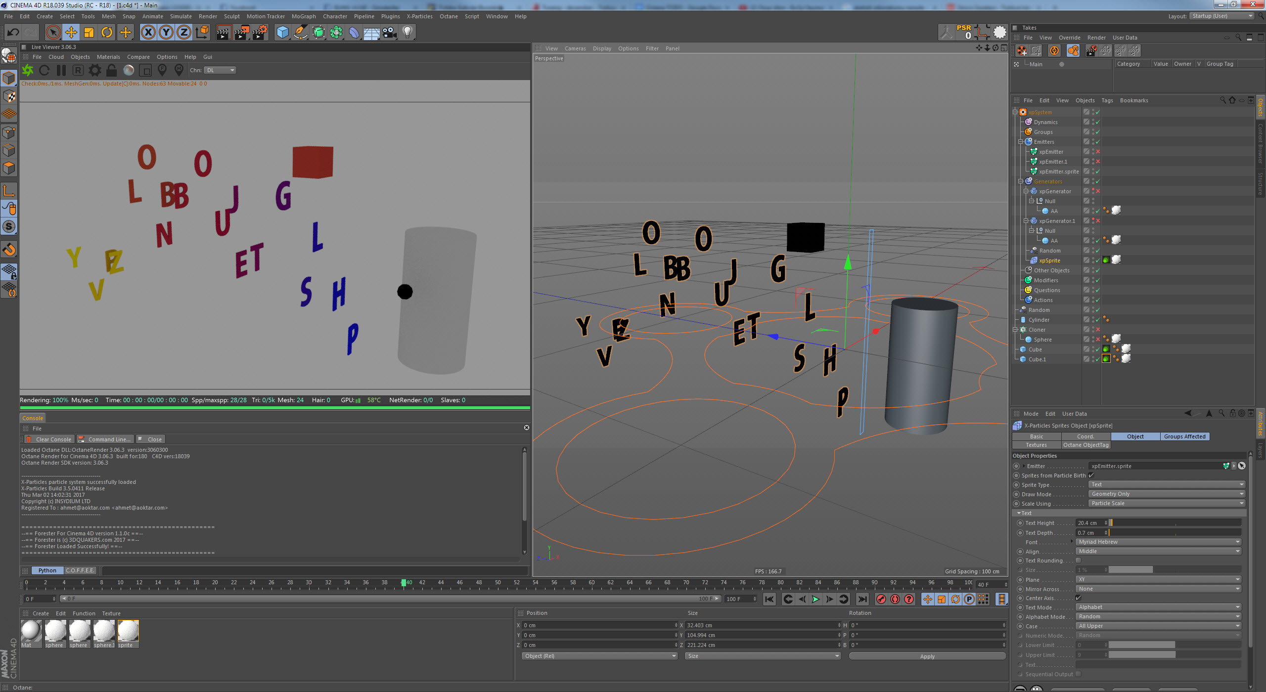

How do you make a randomised color setup with standard renderer+xp? Forget it, i've discovered.
Here's what i'm trying to do for next version. We'll have some new features to assign user colors to any kind of geometries. So it will be possible to support xp generators for randomised colors. See image from my first tests.
