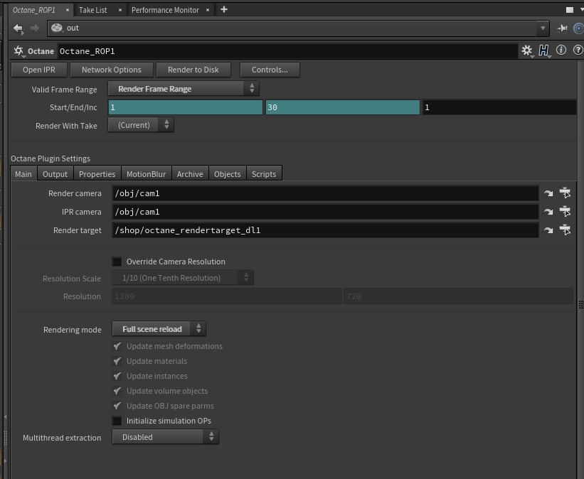

Hello,
There is no problem with openIPR,
When rendering to Disk, nothing is rendered.
Is there a way to do it?
Thanks,
tomo

This kind of scenes that have objects without a constant topology among the frames can't be rendered in update mode. Please, set the rendering mode to "Full scene reload" in the ROP node.
Thanks,
-Juanjo

Thank you for your quick response.
Your advice was very helpful.
Thanks,
