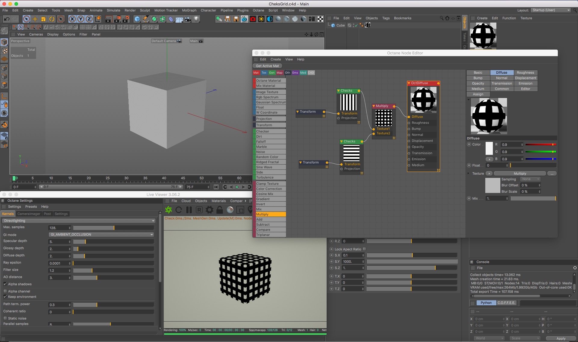

Pretty basic question! "The Checker procedural texture is useful for making stripes, checker board and grid patterns" How!?!?
Any help very much appreciated!!
Posts: 10626
here is an example of grid with two multiplied Checks nodes:
CheksGrid.c4d.zip
(47.73 KiB) Downloaded 524 times

Perfect! Thank you soooo much!!
