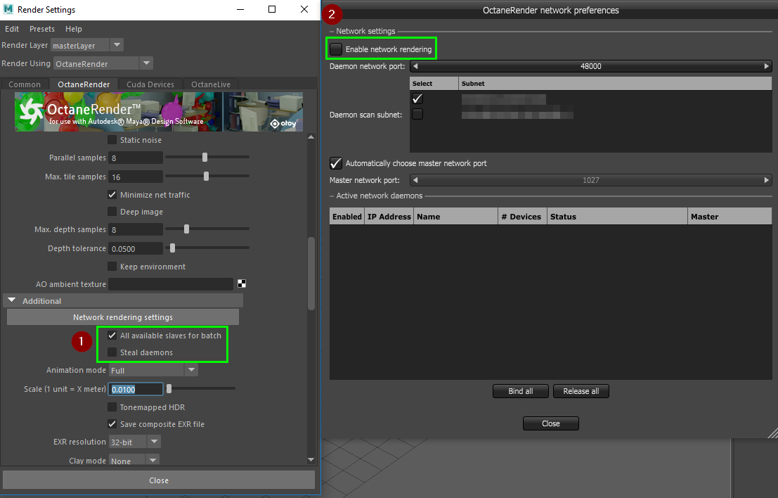

While we are investigating, please try these options..
1. From the render settings dialog, enable "all available Slaves for batch".
2. Uncheck the "Enable Network Rendering" option from the Network render settings. This option will work for IPR only.
Now, save the file and it is ready for batch render. Please let us know how it go.
