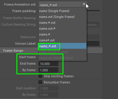

Hi Darren :)
Please make sure the "frame animation extension" parameter is set to name_#.ext from the render setting's Common tab.
Also, here's our latest stable build viewtopic.php?f=109&t=62064.

https://u4752079.dl.dropboxusercontent. ... aya_v01.mb
I have a frame range setup, you can inspect the file by downloading it from the link above, it's a very simple test scene.
