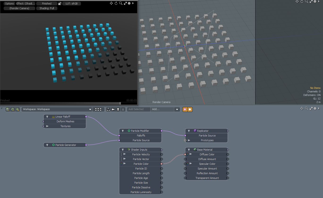

Is it possible for octane to access the color info of the replicator to color each instance individualy ?
Like this setup in the modo render, as you can see the linear falloff drive the blue color this is what i would like to be able to replicate.

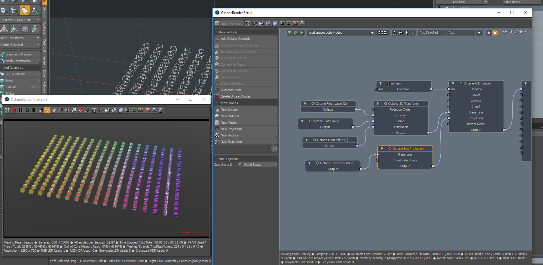

Hi - I think Mograph is using a world space projection to achieve this. So in Modo, add an Image to the Prototype Mesh shader, then add an Octane Override to the same material group and set the Projection of the Image to Box, World Space.

Hi ,actually mograph use the real color info on each object, not just a map.
The mograph shader is just a way to use these info in a real shader.
I'm trying to achieve the same thing, to be able to control color directly with modo falloff object (and not map or wathever) using the particles color info.
As you can see in this scene file, the cube's color are driven by the particles modifier and corresponding falloff, wich give more freedom and easier control.
Modo extract the color info of the instance with the shader inputs node.

Sadly i don't own a C4D octane license, all i know is that it work's this way with redshift and i've seen video of people doing that kind of thing with octane too, controlling the color/emission directly with mograph effector and falloff without the use of map.
Maybe someone here with octane and C4D can make that file for you.
My guess is that it can do this because the cloner (some kind replicator equivalent) or whatever you want in C4D doesn't treat object as instance at first, so he's allowed to adjust parameters on each one independently, and so octane get the color attribute somewhere at render time and then create temporary copy of the material, change the color where there is that mograph shader and then apply it.
All of this of course is purely theoretical, and could be a nightmare to implement....but if they can do this on another software, maybe we can on modo too

Modo Replicators translate directly to an Octane Scatter node - so in the situation you have described, there is a single cube which is the source of an Octane Scatter node with 100 transforms (being the cubes in the grid pattern). Octane provides no direct way to change the material of specific instances so all 100 cubes will have the same material. So the only way to change the diffuse color of specific cube instances is to use a texturemap with the UV Projection changed to Box and the project changes to have the projected image cover the extent of the cubes. This is the approach I suggested earlier in this thread.

Yes i understand this workaround, but it will work only on simple pattern, if i want to animate the falloff, wich is the point here, on more complex pattern it will become not really viable as we would nedd to bake the color animation each time we change one thing :/
