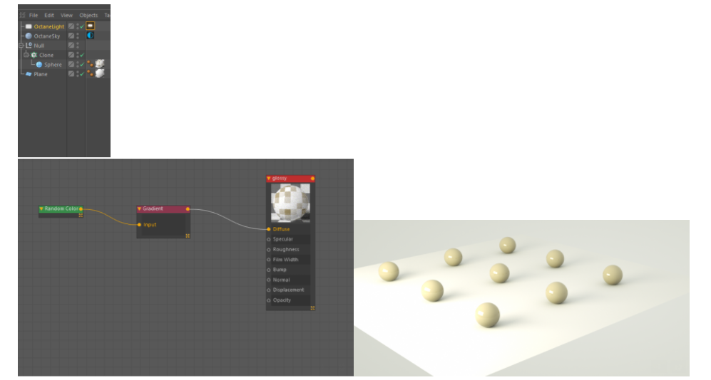

Hello I am having trouble making this work :
https://www.youtube.com/watch?v=2jIEdg0TEHo&t=3s
I follow the simple step and I am not able to make this work .
Anyone can help with the set up of the random color on mograph cloner ?
Thank you!
simple light on the left side

You can check sample scenes for randomcolor or mograph samples. Randomcolor will work with render instances not real clones.

aoktar wrote:You can check sample scenes for randomcolor or mograph samples. Randomcolor will work with render instances not real clones.
Thank you very much
