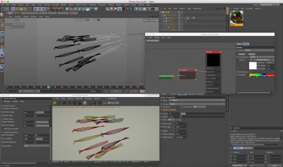

Hi guys,
I'm having trouble applying the random color node to generated geometry using sweep nurbs and a tracer.
Please have a look at the attached file.
I want to apply a different color for each generated "cable" but for some reason it wont work as it doesnt generate seperate "objects".
Any ideas?
Thx

Hi Jugro,
since the sweep nurbs is a single mesh, the Octane Random color cannot work.
You need also to have the Render Instance option active to make it works properly: ciao beppe
