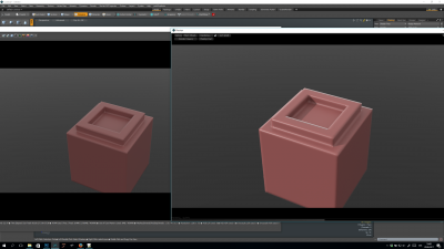

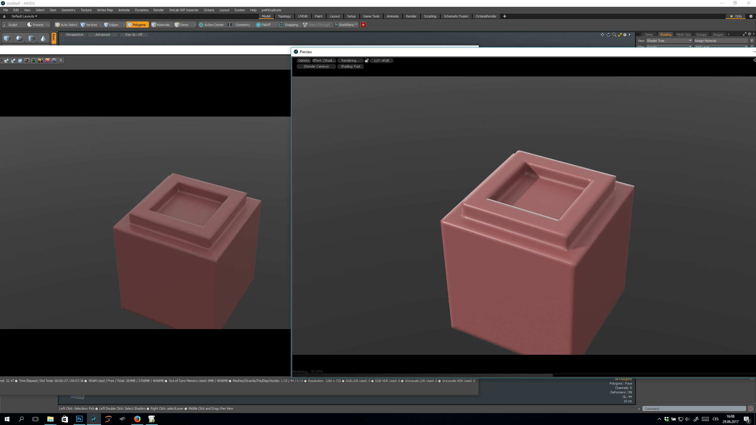

Thank you Paul, it works now. However, it's making those weird shapes as you can see in attached image. Is this something that I can fix or just a limitation of Octane?

Hi Jakub - that is probably a limitation of Octane. However if you increase the polygon density of the cage mesh (Geometry->Polygon->Subdivide), you might be able to improve the result.
