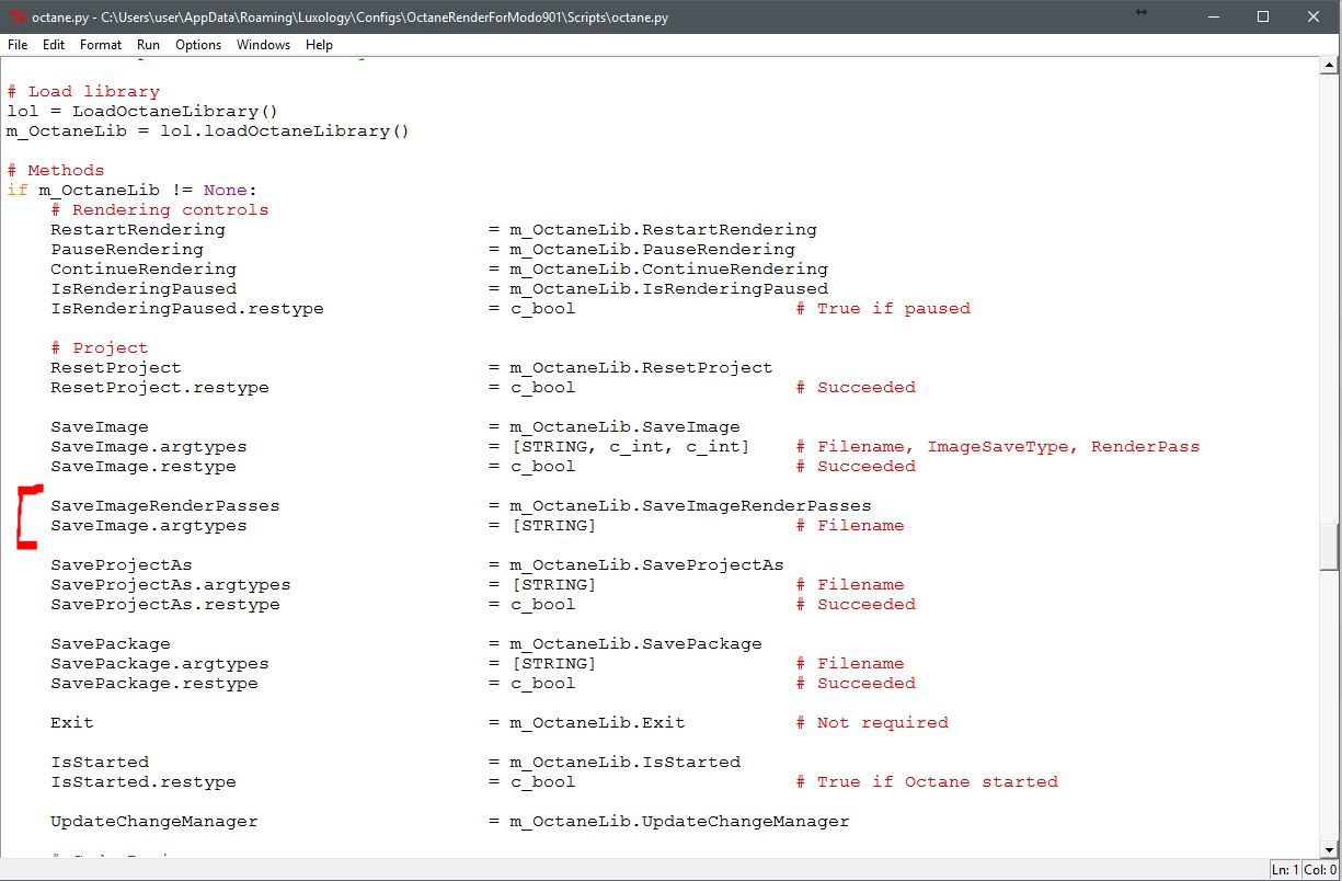

Will this be possible in future releases? Or is there maybe a way to write a script for this?
I found a line like this in the octane.py file (see attached screenshot)
I´m not really familiar with scripting, but if you would say that there is a way to write a script for it, maybe we would spent some time to figure it out.
Yes, you may well be able to do this with python. Use SaveImage, with the third parameter being the render pass number (you will need to do some experimenting to see how this number correlates to each render pass).
