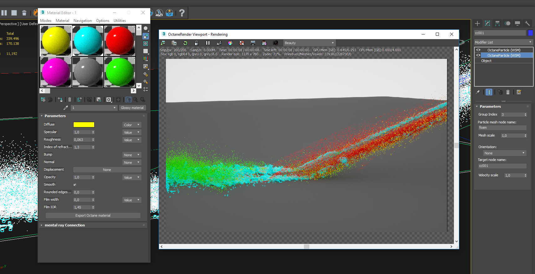

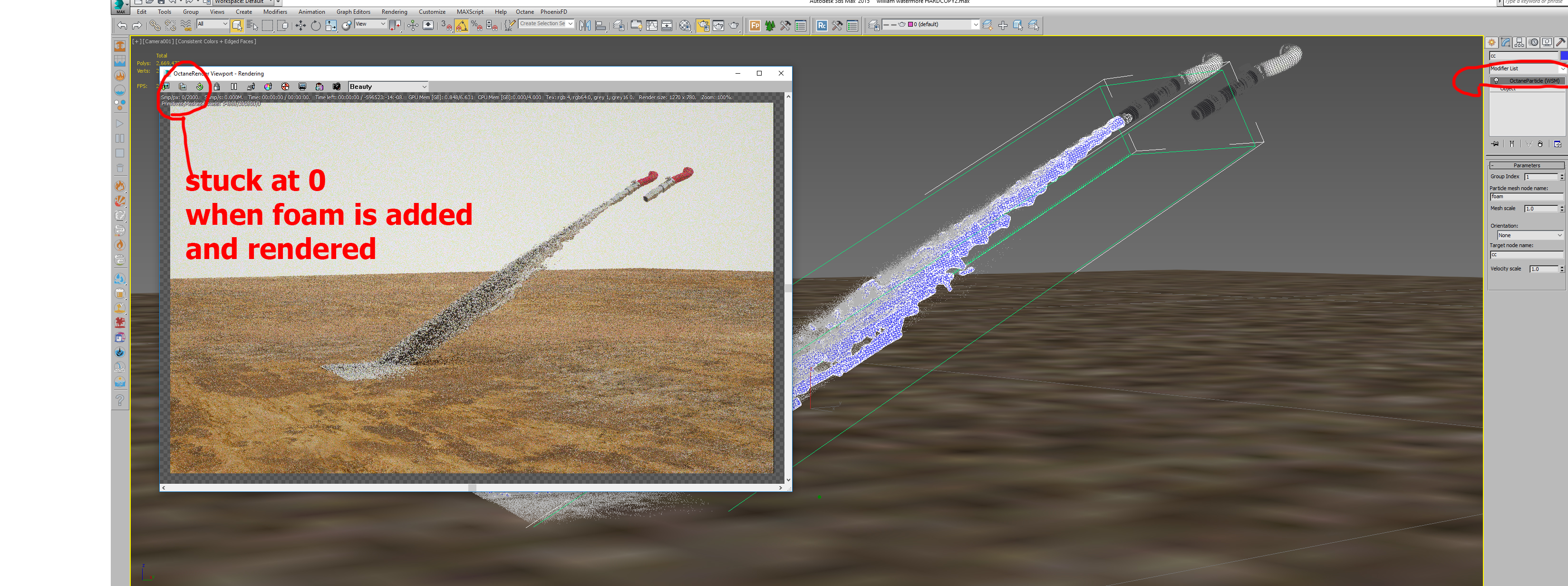

Hi When you add octane particles modifier for foam and also select liquid sim box>octane properties and enable mb, vertex mb, mvalbe proxy and open octane viewport it is stuck at 0 samples
scene attached got to frame 8-9 for my simulated files or simulate first. If your rendering is not stuck at 0 jsut scrub timeline
Octane does not render with mb on in Phoenix

Hi coilbook,
I checked your issue, it happens in OctaneRender Viewport but MB works in Render.
I'll send it to developers.

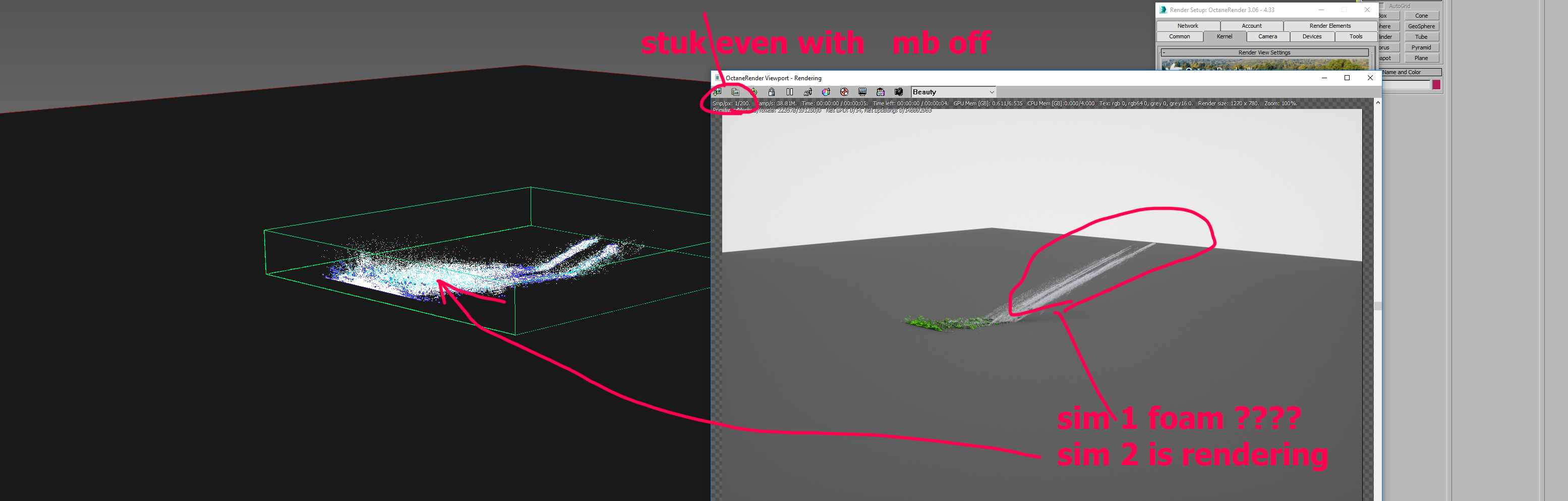

Hi Paridie

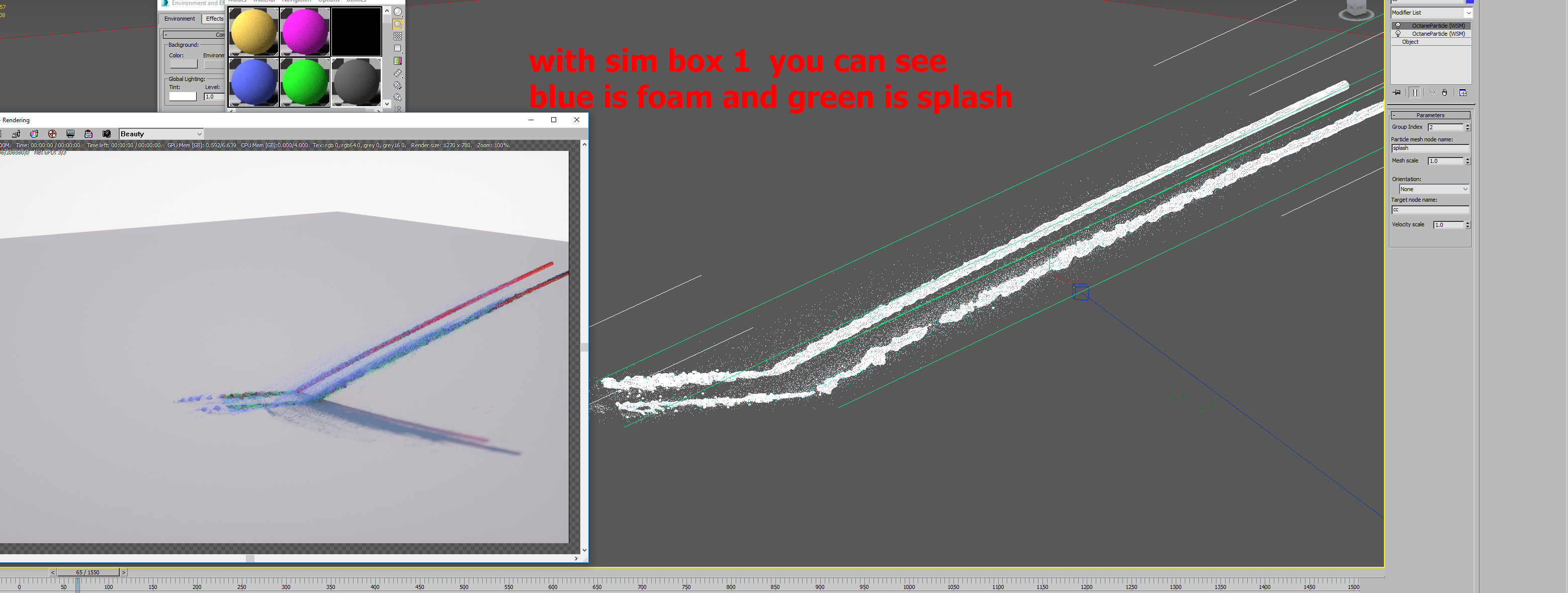

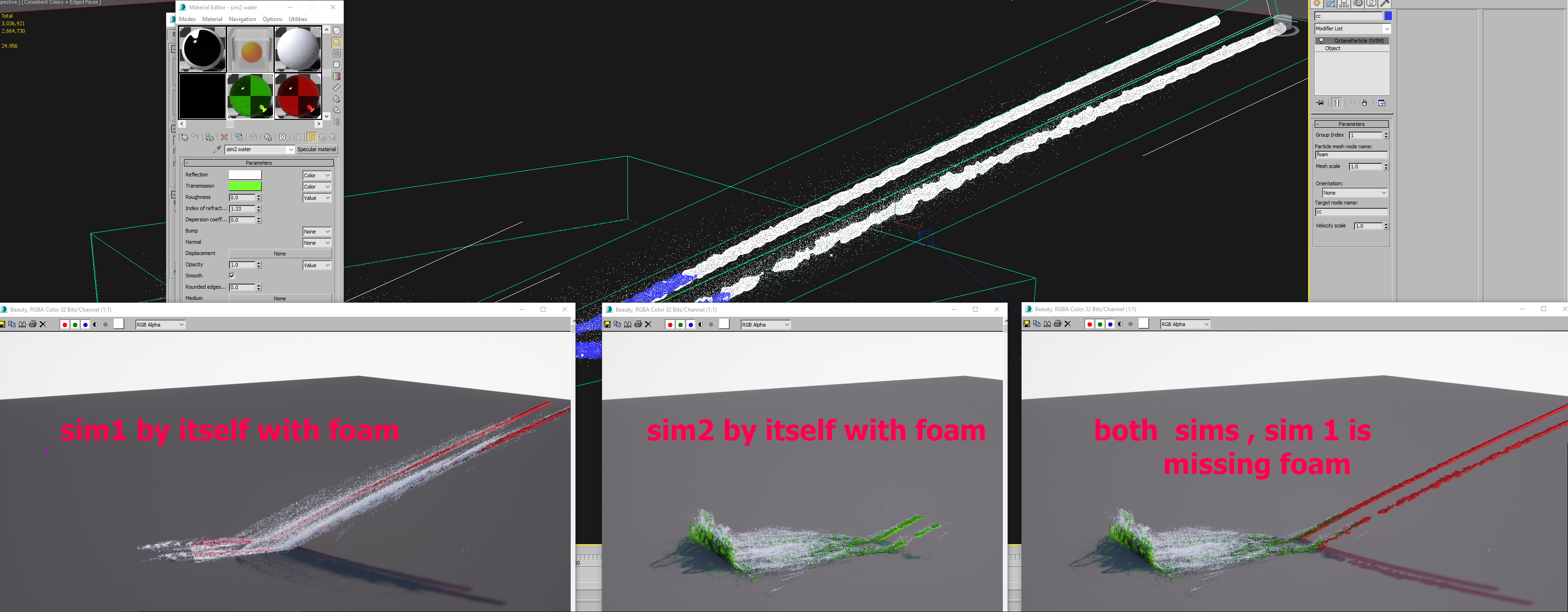

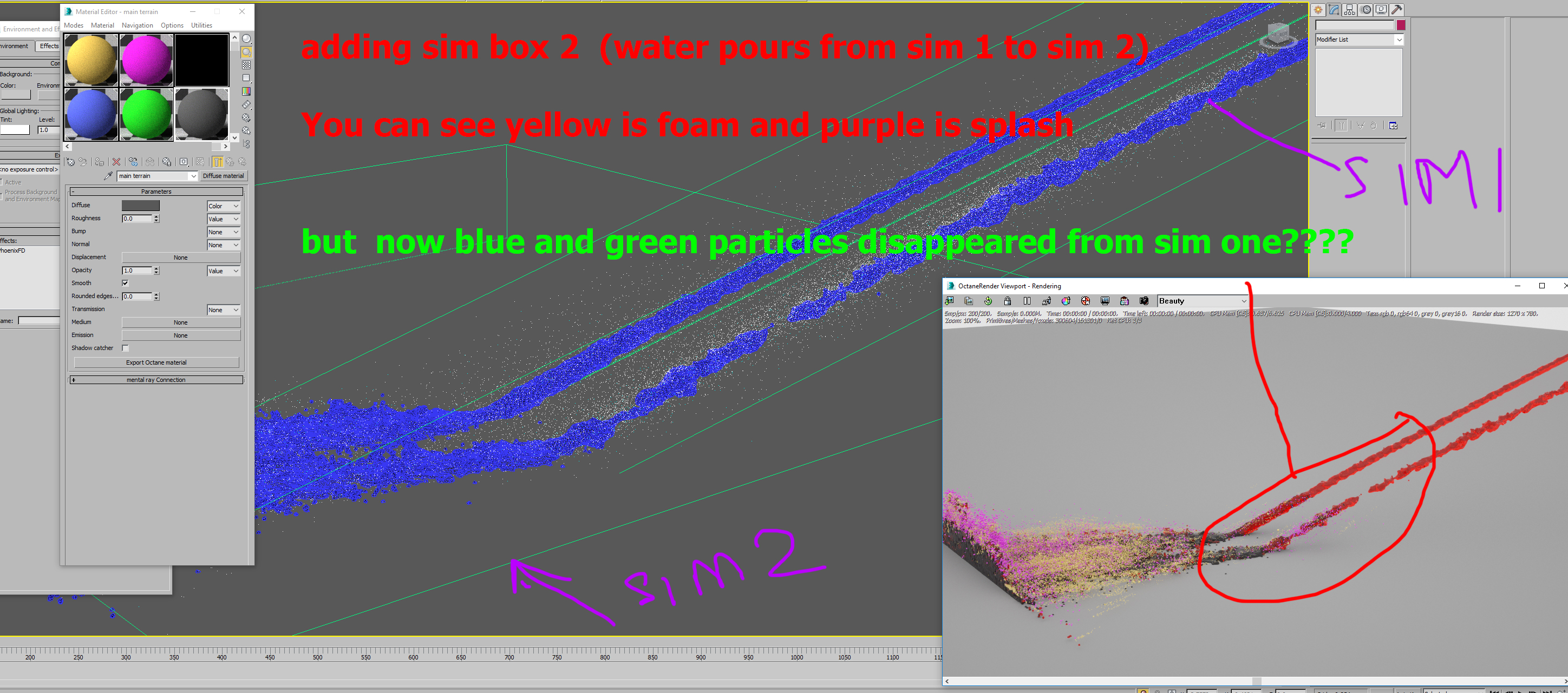

we are having a major problem with foam and mist not appearing when using two sim boxes
You can see sim1 box water pours into sim2. After sim 1 is done calculating sim 2 starts calculates sim1's incoming water. Problem is splash and foam from sim 1 box disappears when sim 2 box is also rendered? is it a bug ?
we need splash and foam from both sim 1 and sim 2
we have to use two sims otherwise it will take years to calculate with one large sim box
i attached the file. You can see sim 2 has foam sim 1 does not. Sometimes it is vise versa. Sometimes sims 2 foam appears away from liquids . please go to frame 65.
also you can see sim2 is rendering but sim1 foam is showing
viewport freezes at 0 even with mb OFF and 3ds max gets very very slow

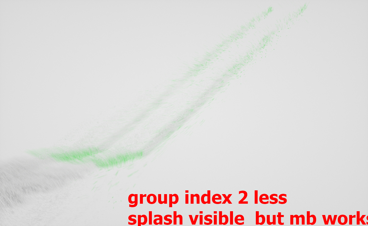

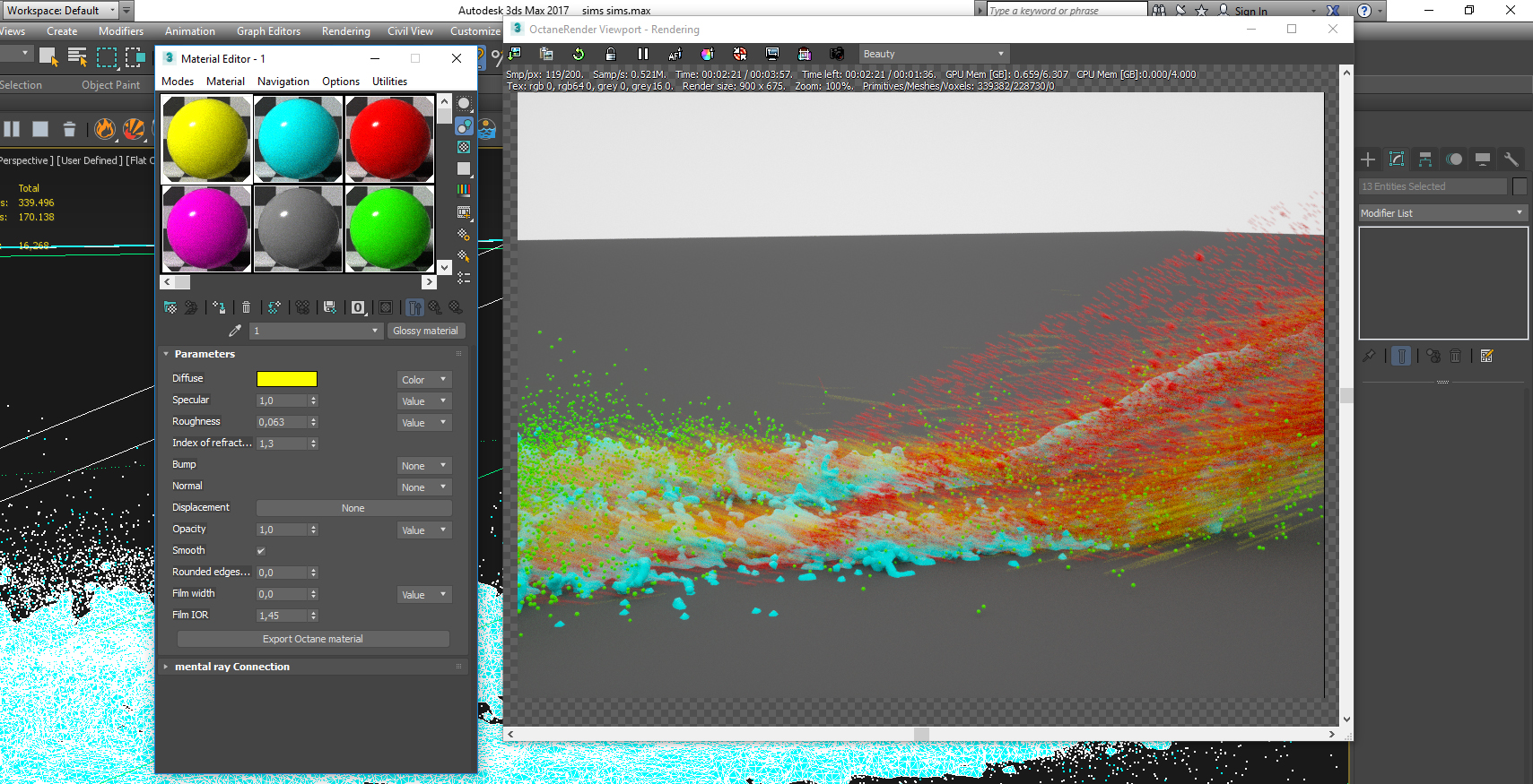

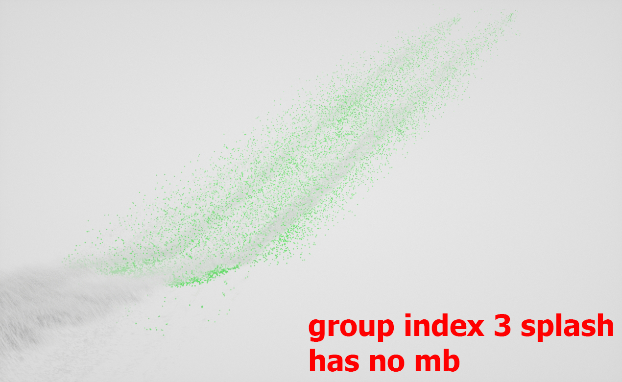

thanks . is group index 1 for foam only? I noticed some of your particles did not have motion blur. I think this is a bug. looks like your second image does not have motion blur for splash (green particles ) and Sim 2 box is missing foamparide4331 wrote:Hi coilbook,
I think these problems depend on some issues about ID and Group index for particle and MB. I will also add these tests to developers.

Hi coilbook,
it looks like an issue about OctaneParticle (WSM) Group Index; no more 3 simultaneously.
It seems to produce malfunction with MB and maybe stucks sample too.
Regards
Paride
