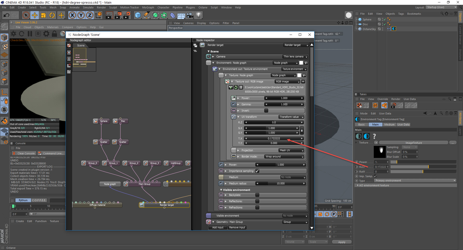

Hi, perhaps i'm the only one person who's annoyed with this particular feature but would it be possible to enter a degree value instead of the float one in the rotX and rotY for HDRi in the environment tag in C4D? I used to use hdri tools like GSG one and i'm really uncomfortable with this octane's feature? Don't know if anybody could also be intersted int that but i like precise values ;-)

You'll see why i'm using this value when you check the picture. It's simply driving a offse value in transform node. See scene for a xpresso.
hdri-degree-xpresso.rar
(95.38 KiB) Downloaded 151 times

Thxs Aoktar for the quick answer and the xpresso file ;) I knew something like this was possible with xpresso but i was unable to make it. I appreciate a lot.
