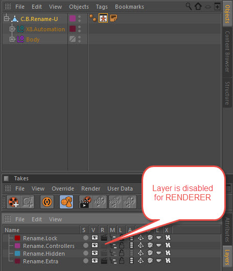

Hello together,
I am new to the Octane Plugin and I already have a problem.
My character rig that I bought is invisible to the renderer.
I can make a cube and the renderer sees it and other character rigs do work.
I tried to give to the invisvble rig a octane-material but the renderer still doesn't see it.
I attached the file so maybe someone will eventually find a solution.
Thanks and I appreciate your time.
I really need help.
Kind regards
JC -

See picture
