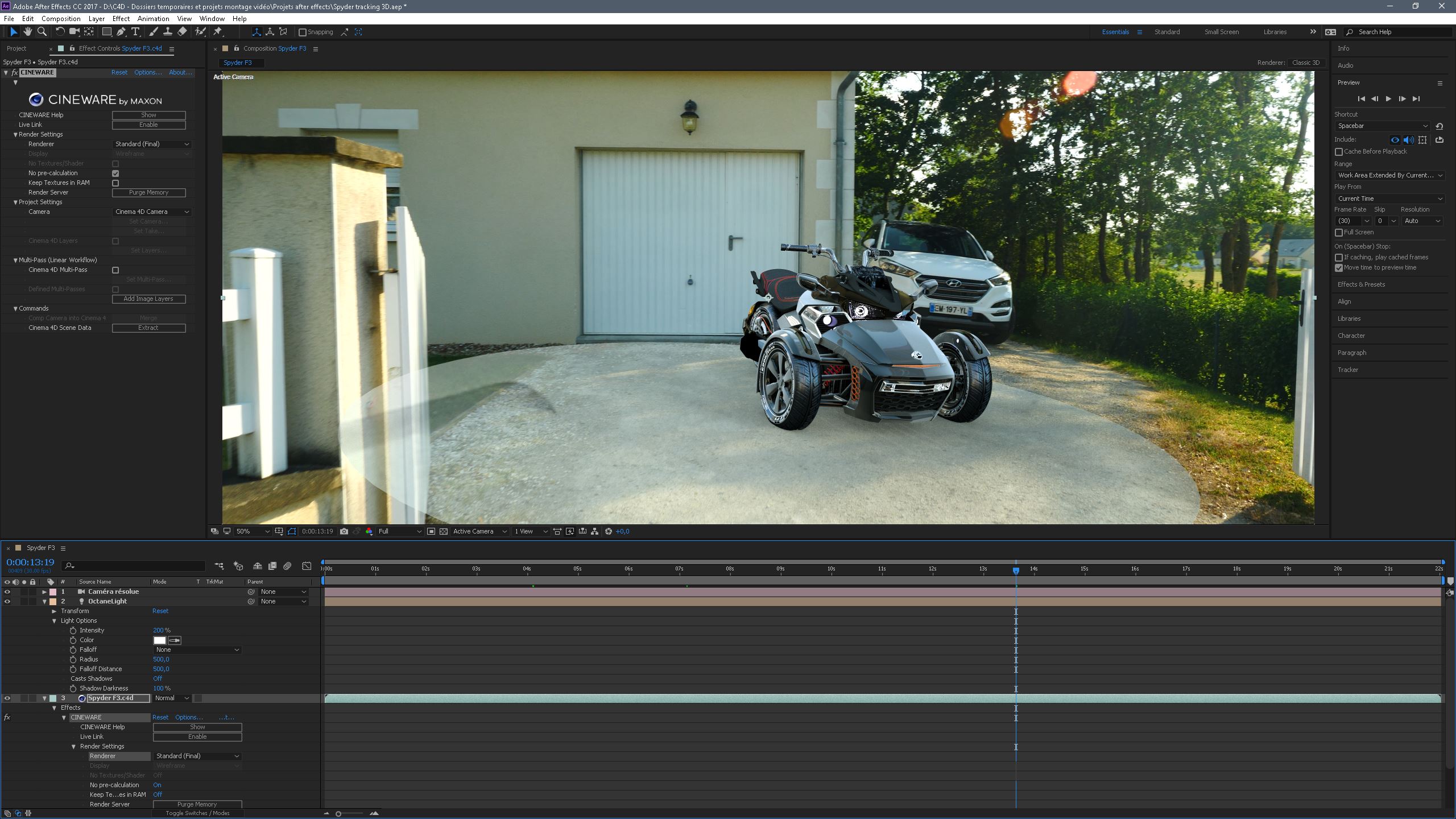

I'm working on a tracking 3D test and I use only a sun Hdri in C4D and compose all in after effects.
the shadow projected on the floor disk with octane matte material doesn't show the shadow nicely.
even if i desactive the sun, a full shadow covers the round ground.
I try to adjust all the light parameters, change kernels but result is the same.
How can I have a natural shadow whitch can fit the round ground ?
thanks
