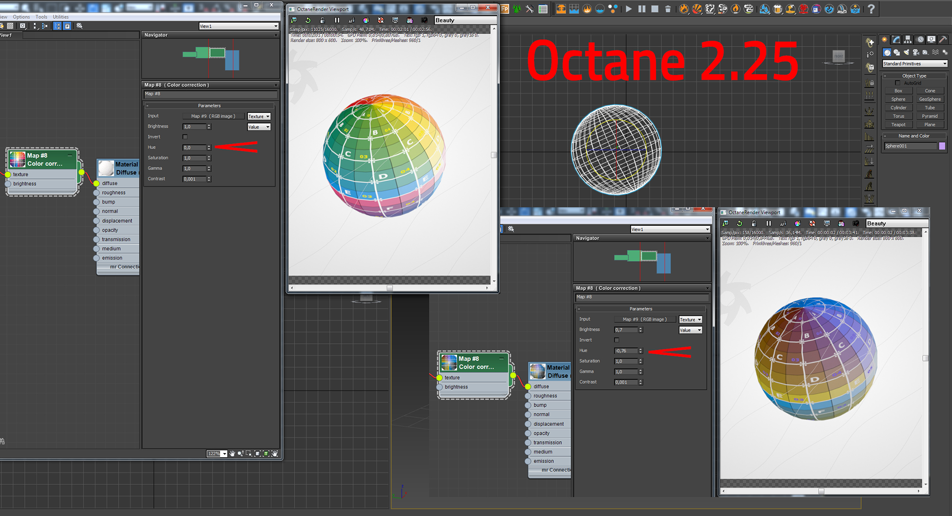

If you take a look at the attached file you see my point.
//Daniel

And as I see it on your attached images it behaves wrong.
It should not go darker as it does in your example

Sorry, I don't suppose I understood just what it was you are saying.
Attached a screnshoot with your file (purple sphere).
I added two spheres, one with color correction node and one without, I do not seem to see any anomalies.
Regards
Paride

Hi again. So this is my last attempt to convince you even though I have done it before. The scene you show here is not the file I sent you or you have resettled the hue spiner from 1 to 0. To me it´s obvious that you don´t want to see the problem here. Why?
If you look at your rendered color spectrum its clear that the behavior of the green for example is not consistent.
Now i put up another image for you, showing what I mean.

I apologize, for misunderstanding, with your last screenshot I understand what you refer.
I thought you referred about wrong match between material editor and Octane render viewport.
What you consider a bug can not properly be called this way; Octane Render is a render engine that works on a spectral color curve, not RGB values.
Color correction node is a transposition of a RGB color correction tool applied to a spectral range, so it is not always possible to have a match.
Therefore, the color correction mode can not be used with absolute precision, but you can think of it as an on fly modifier for images/textures etc.
I'm not a developer, but I think OSL can solve issues like this.
Regards
