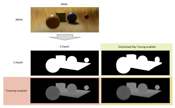

Hi dflamholc,
what about the Distributed Ray Tracing option in the info pass settings?
