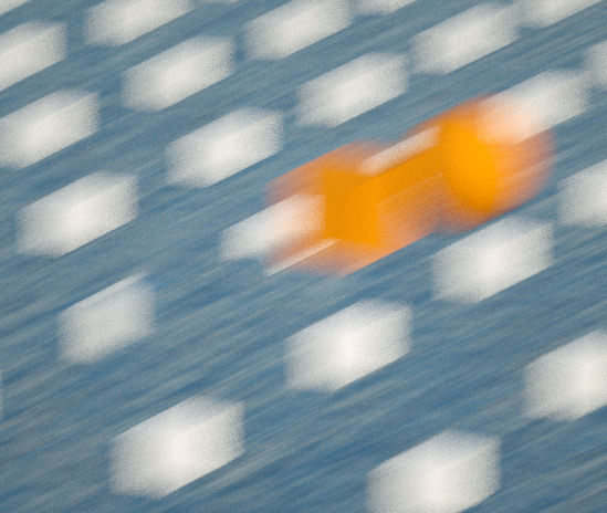

Hi I have problem with motion blur. If camera follow objects there is everything blurred even objects (camera 1).

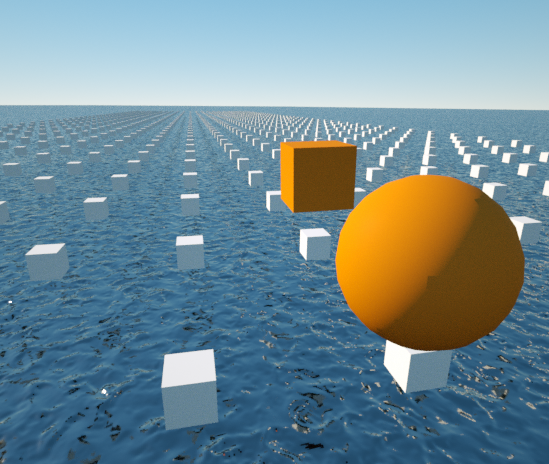

If camera is moving with objects and fly above ground, there is nothing blurred (camera 2 and 3)
. Thanks for help.

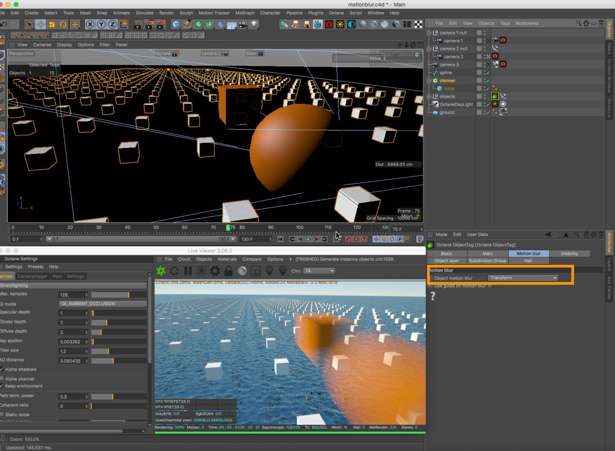

Hi Mibu,
you have forgot to change the motion blur setting in the Object tag. If you change it to Transform, the orange objects are correctly blurred:

bepeg4d wrote:Hi Mibu,
ciao beppe
Hi, but orange objects should be sharp and everything else should be blurred. I am trying different ways but still not work.
