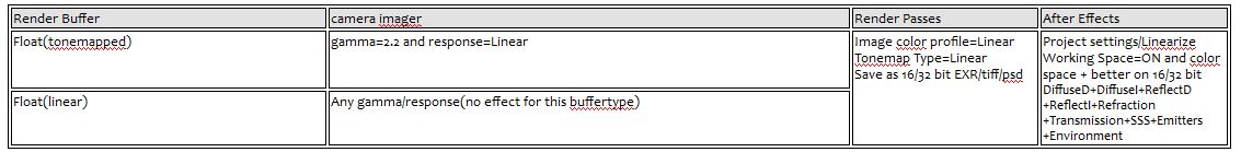

Have you tried these way? You should not apply any gamma to individual layers. Keep gamma=1 without touching.

Hi Aoktar,
Based on that documentation, camera imager gamma and response shouldn't matter. According to the documentation it has no effect if the Render Buffer is set to linear.
I believe my pass rebuild is the same, I'm not using indirect/direct as Diffuse should be the combination of the two anyway. Same for Reflection.
My build is Diffuse+Reflection+Refraction+Emitter+Ambient.
Since my environment is set to all black I assumed that meant it wasn't providing any light and as such isn't needed. Is this incorrect?
Also do my passes need to be RAW to work with linear?

Oh shit, I think I get it. You're saying that because my camera imager is set to 2.2, what I'm seeing in the Live Viewer is wrong, not the other way around. If I change my camera imager to 1, and then light based on that, my linear composite should work.

I'm not very familiar to purposes or common usages of regenerating image from passes. Btw you don't need to change anythings from default parameters of render setting. Keep it how was it and just use 16/32 bit exr/tiff/psd for saving. I'm not sure about impact of RAW parameter. Other than this, don't forget that: LV is displaying tonemapped results for passes and main buffer, but passes in PV is linear by default. This always makes confusions. See this video: https://vimeo.com/201203670
Just revisited the new docs on render passes.aoktar wrote:Have you tried these way? You should not apply any gamma to individual layers. Keep gamma=1 without touching.
https://docs.otoy.com/Cinema_4D_Plugin_ ... s%7C_____1
It says best results in AE is to save as 16-bit EXR/TIFF/PSD files but how's about PNG files?
