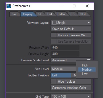

I had the earlier 3.0.6.0.x test versions installed on my work computer and then upgraded to the 3.0.6.0.5 stable plugin, however I am still getting the debugging information windows popping up when I enable Octane, and when I use IPR or render with network rendering (it tells me how many CPUs and GPUs my computer is using). I have removed the plugin and its files, restarted LW to make sure it's cleaned out of it, and then tried again with no luck. I have even deleted the .cfg file. It doesn't do the same at my home computer, but I cannot figure out what is different.

Probably your problem is related to the LightWave alert level parameter. Set it to medium or low to avoid the message windows.

Yessir, that was it! Many thanks, Juanjo!
