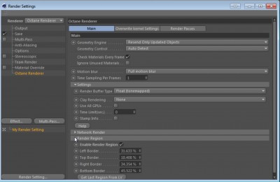

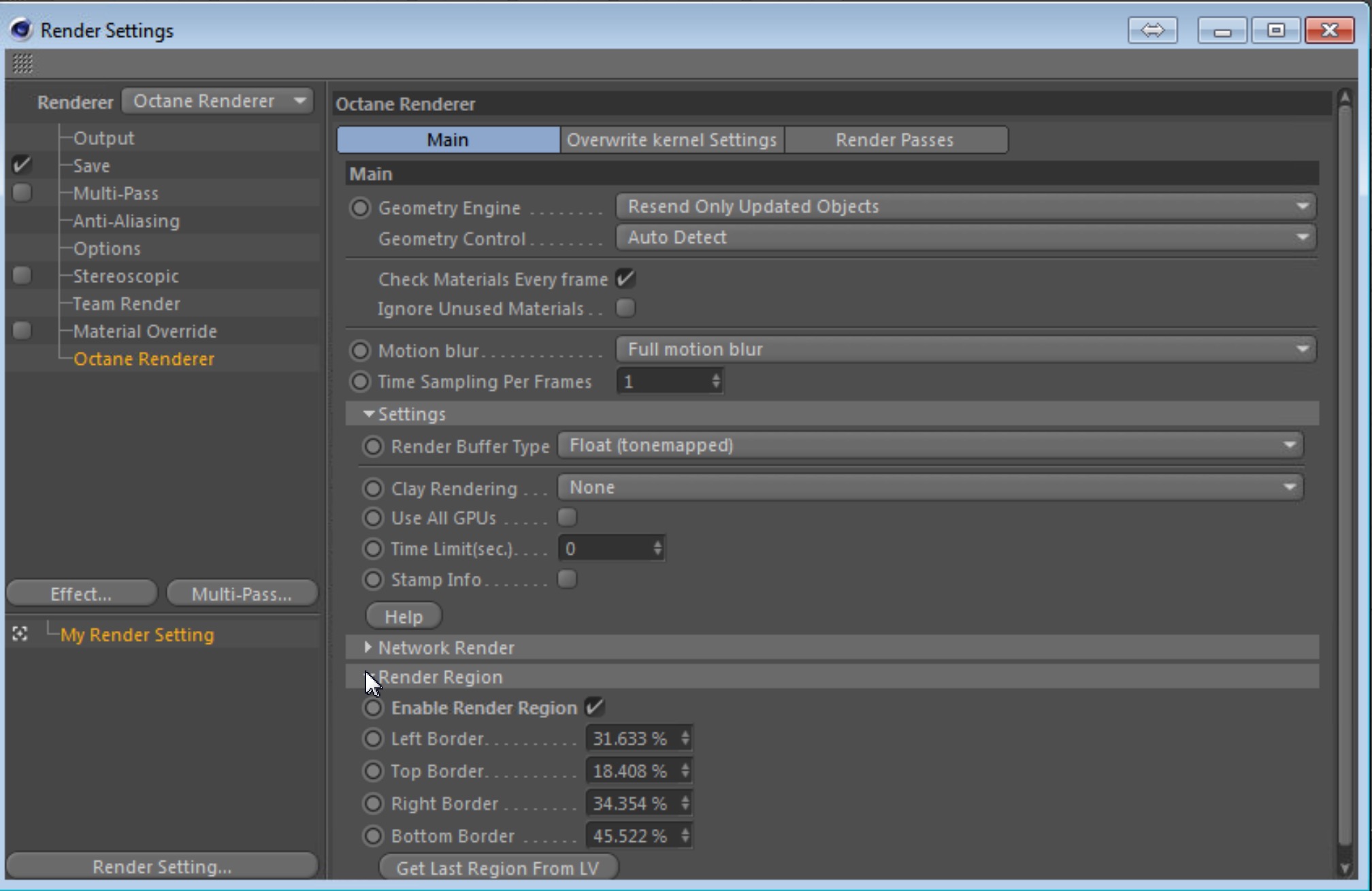

yes sure, after selectin a region in LV, go to Render preferences OctaneRender main tab, and at the botyon there is a Render Region section:
You can press on the "Get last region from LV" button to transfer the selection proportionally on your high res render in PV. Note that you can also animate the region durin time if necessary.
