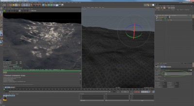

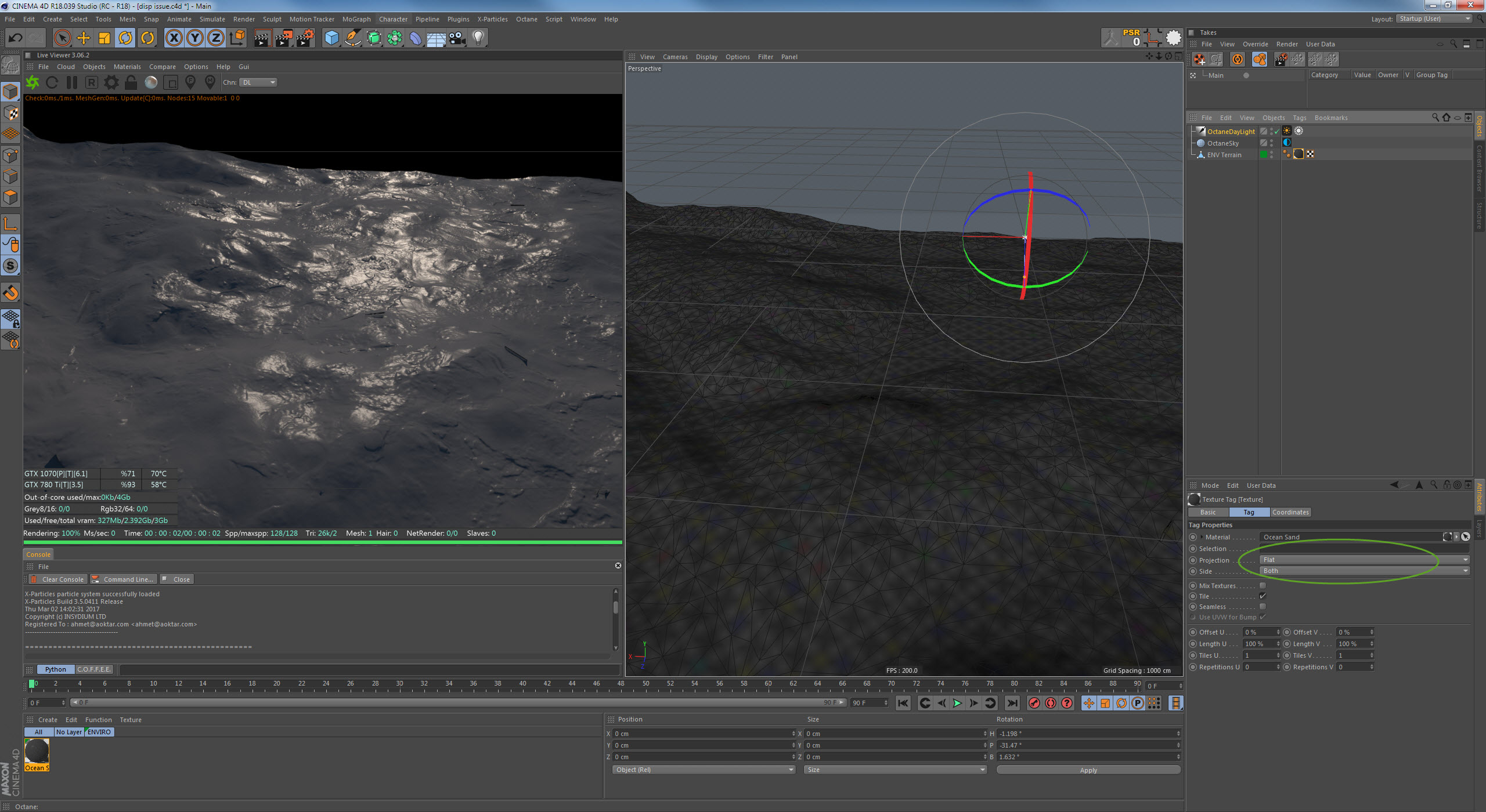

I have a problem with displacement tearing polygons. I found one post from Beppe where he is saying to turn of Phong Tag. I did that but it does not help.
I have as well a problem that displacement texture is not responding to texture projection node and it is still using object UVW. This looks like bug to me. I have attached the scene.
I am using the latest version of Octane.

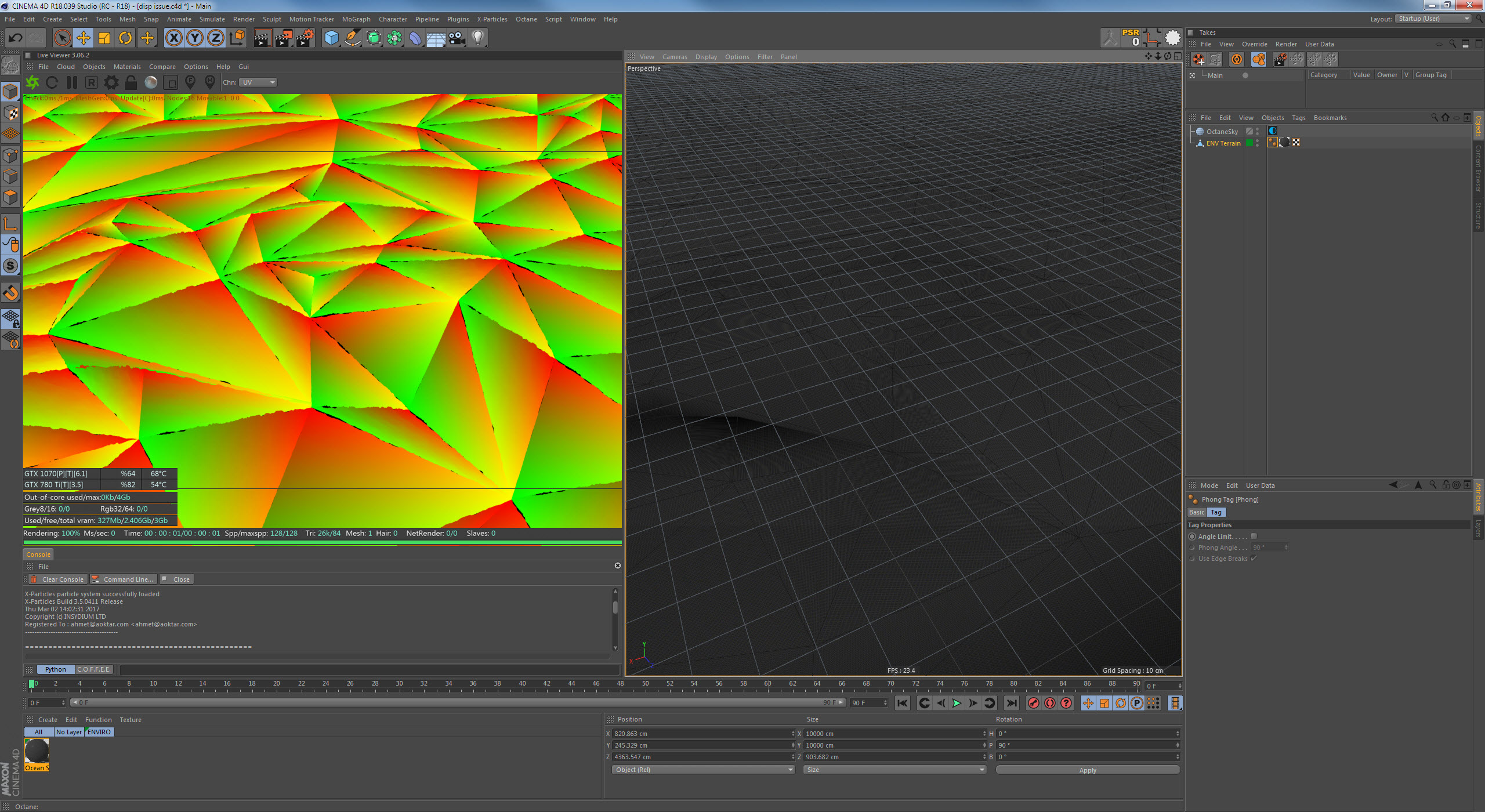

UV coordinates has not any continuty. And Octane Projections will not work in displacement. You have to provide good uvmapping from texture tag.

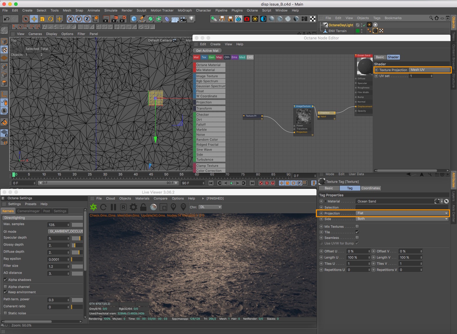

as already said by Aoktar, this kind of uv mapping cannot work with Octane displacement, you cannot have overlapping uvs.
The solution is to leave the displacement in Mesh UV Projection mode, and change the c4d projecion to Flat or Cubic:
