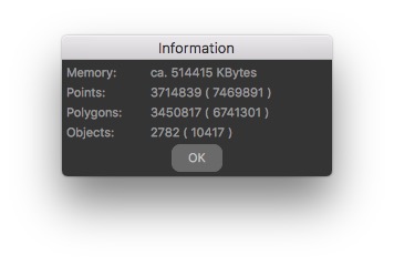

I have a pretty heavy scene, but until yesterday it rendered very fast - ca 11 sec per frame (720p)
But suddenly this changed significant; I just made some minor adjustments to the scene and now one frame needs 50 seconds!
Suddenly the preparation time per frame are very high (20-30 seconds)..
So I tried older versions of the scene (before the adjustment), but the render time still is 50 sec.
I also tried older versions of Octane (3.05.3, 3.06, 3.06.1) without any change...
Any idea or suggestions?
Thanks, Andreas.

You should check console window for octane render log. Do it for PV and LV.

aoktar wrote:You should check console window for octane render log. Do it for PV and LV.
This is what the Log says:
FRAME 1940 fps:25
MB:0/0 ST/MOV:0/2313 Nodes:7756 Tris:12.049m DispTris:17k Hairs:0 Meshes:111k
VRAM used/free/max:3.725Gb/1.031Gb/6Gb Out-of-core used:0Kb total used RAM:26.886Gb
MotBlurTM=0.001 sec. createTM=1.031 sec. matTM=0 sec. updateTM=28.372 sec.
Device:0 TotMem:6Gb rtData:508Mb film:15Mb geo:2.568Gb node:251Kb tex:662Mb unavailable:1.244Gb
renderTM:21.969ms. totalTM:51.373ms.
Posts: 16068
Location: Türkiye
UpdateTime=28 second is on Octane side as you can see. That's nothing about plugin. But you can try to find why you have increased polygon counts after some tweaks.
