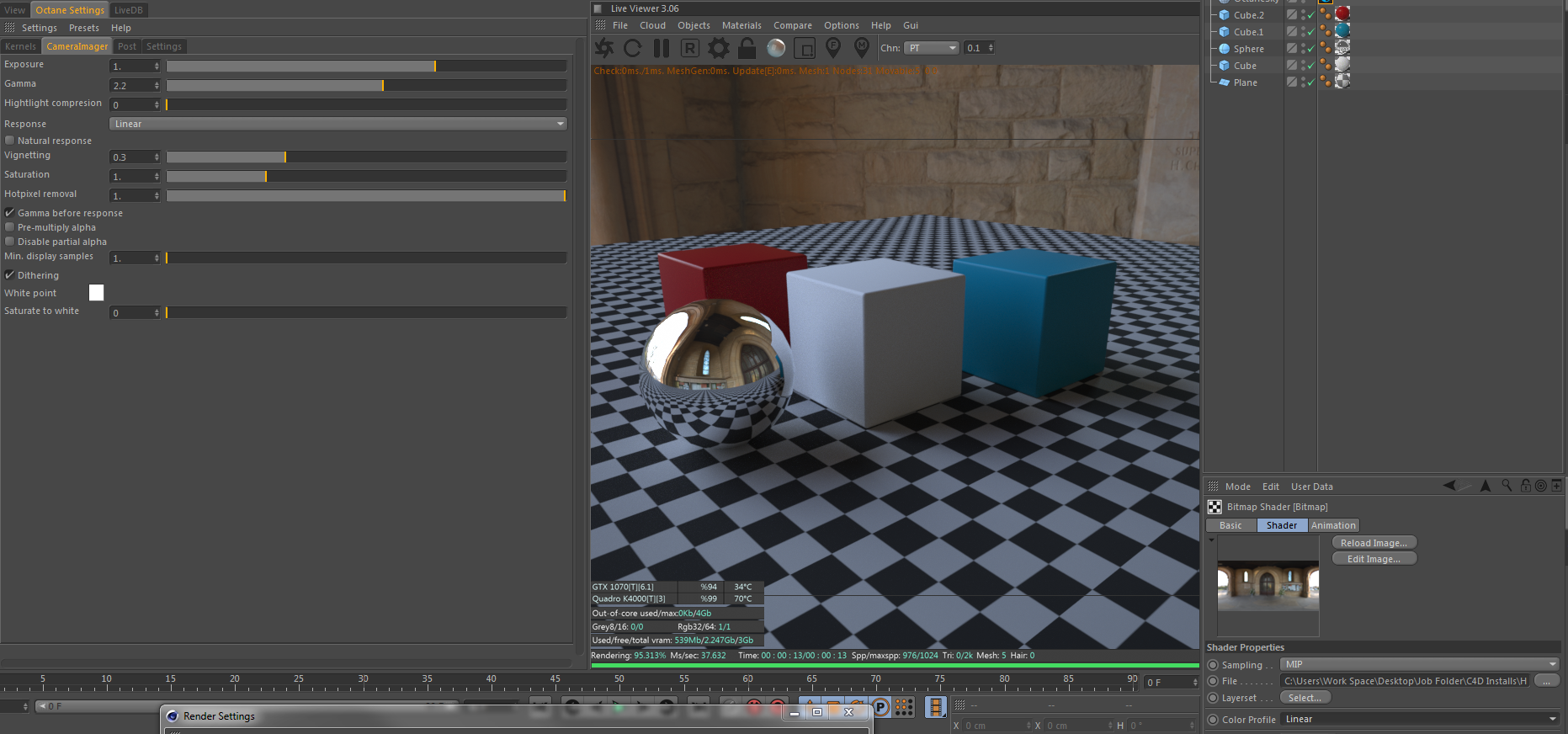

I did a test so you guys can see whats happening.
The first image is of my scene rendered in C4D + Octane
1. Please note the Octane settings on the left. Linear is selected and i am using a gamma of 1
2. Also, note in the lower right, the HDRI has its profile set to "Linear"
See how dark the image is? And if i adjust the gamma or exposure to try and brighten it up, that doesnt help. Its the tonal range thats all messed up.

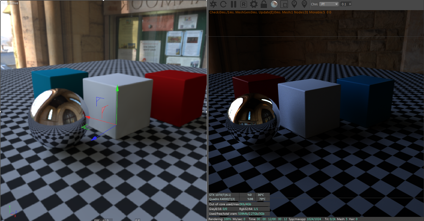

The second uploaded image:
This image shows the scene on the left rendered in physical. This is my standard linear work flow with Physical Render. Perfect, nothing unexpected. Now look at the messed up tonal range on the right...thats in octane.
RSgraphics
Posts: 143
Joined: Wed Aug 03, 2016 4:04 pm
Heres the second image i was refering to

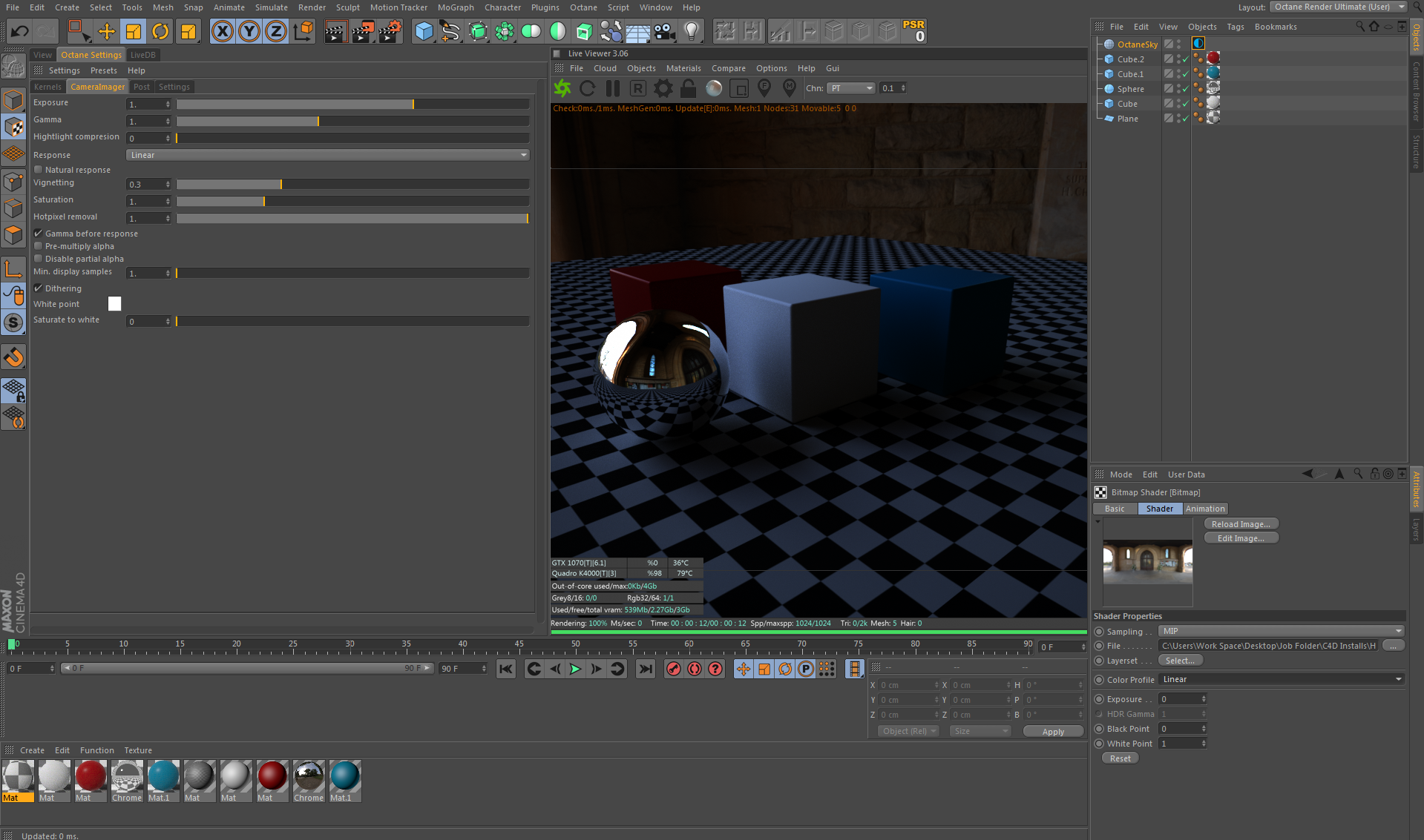

I guess i figured it out. For some reason in the Octane settings, the gamma needs to be set at 2.2 for a Linear workflow. This is odd, i always read that in a linear workflow your gamma should be set to 1.0. But as you can see, now that i switched the gamma from 1.0 to 2.2, it matches the Physical Render image in my first post.
I will post back if i run into any hurdles with this issue. Im going to test more HDRs.
