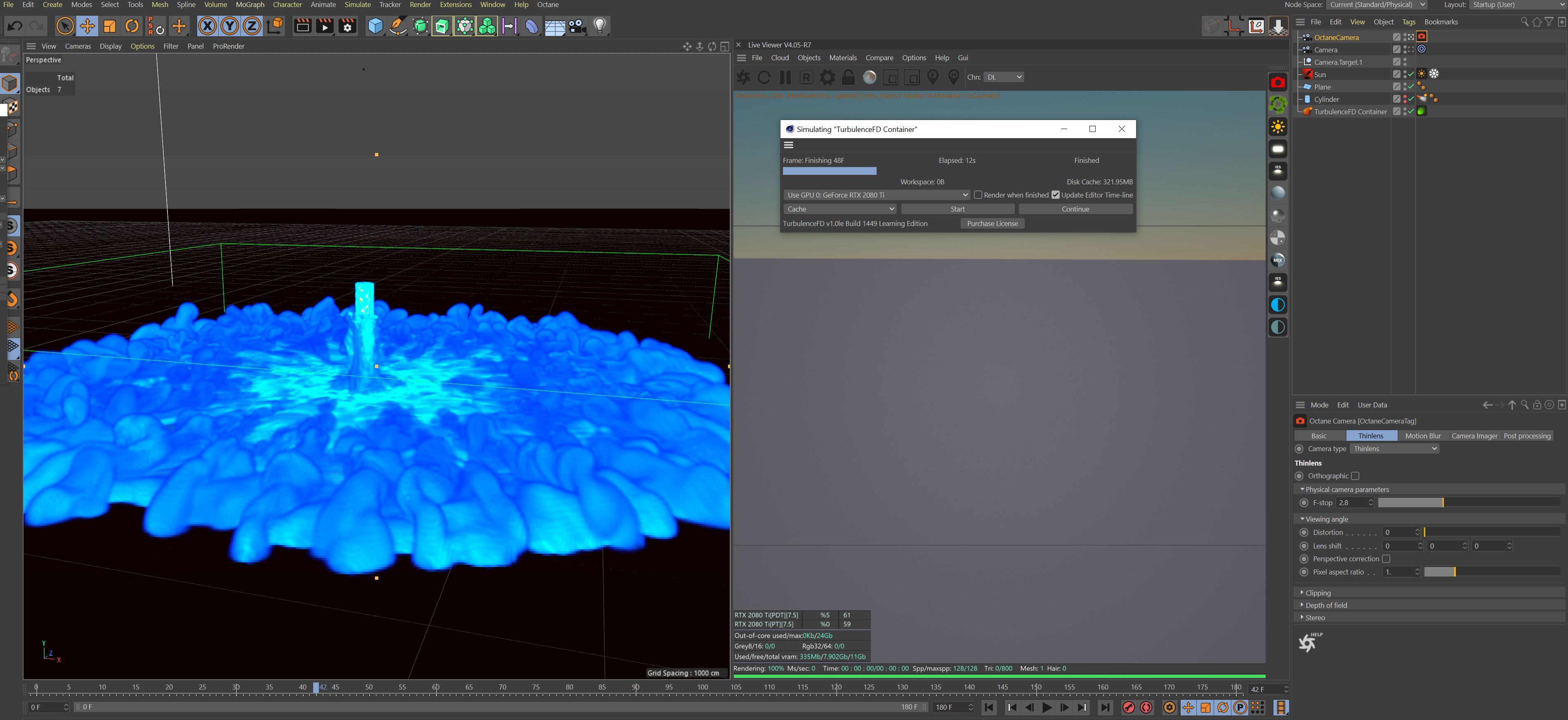

whenever i try to render out the stuff i've done with Turbulence fd in the octane live viewer, it doesn't even show up on the live viewer. i've looked @ many post with people with similar problems as me, but i haven't found any solutions...
i'm fairly new to octane and Turbulencefd so there could be something i'm missing. and i'm 99% sure i don't have the demo version of Turbulence fd as there is no watermark. so if anybody could help, it'd be greatly appreciated!

You need to add Octane Object Tag to the TurbuleneFD container.

And you may check samples for TFD scenes. You may need to tweak some parameters for medium part in object tag.

aoktar wrote:And you may check samples for TFD scenes. You may need to tweak some parameters for medium part in object tag.
https://render.otoy.com/plugindownloads ... scenes.rar
i've tried using the samples, but it doesn't work still
Jewsephed
Posts: 9
Joined: Sat Jan 07, 2017 6:46 am
Yan wrote:You need to add Octane Object Tag to the TurbuleneFD container.
thanks, this worked
You may need to run simulation before rendering. Most of scenes are working as i could see. At least you can see how they're set with octane object tag.

Hi
I have the same problem
I downloaded the documents you have shared all the settings, although I still can not get render help please
