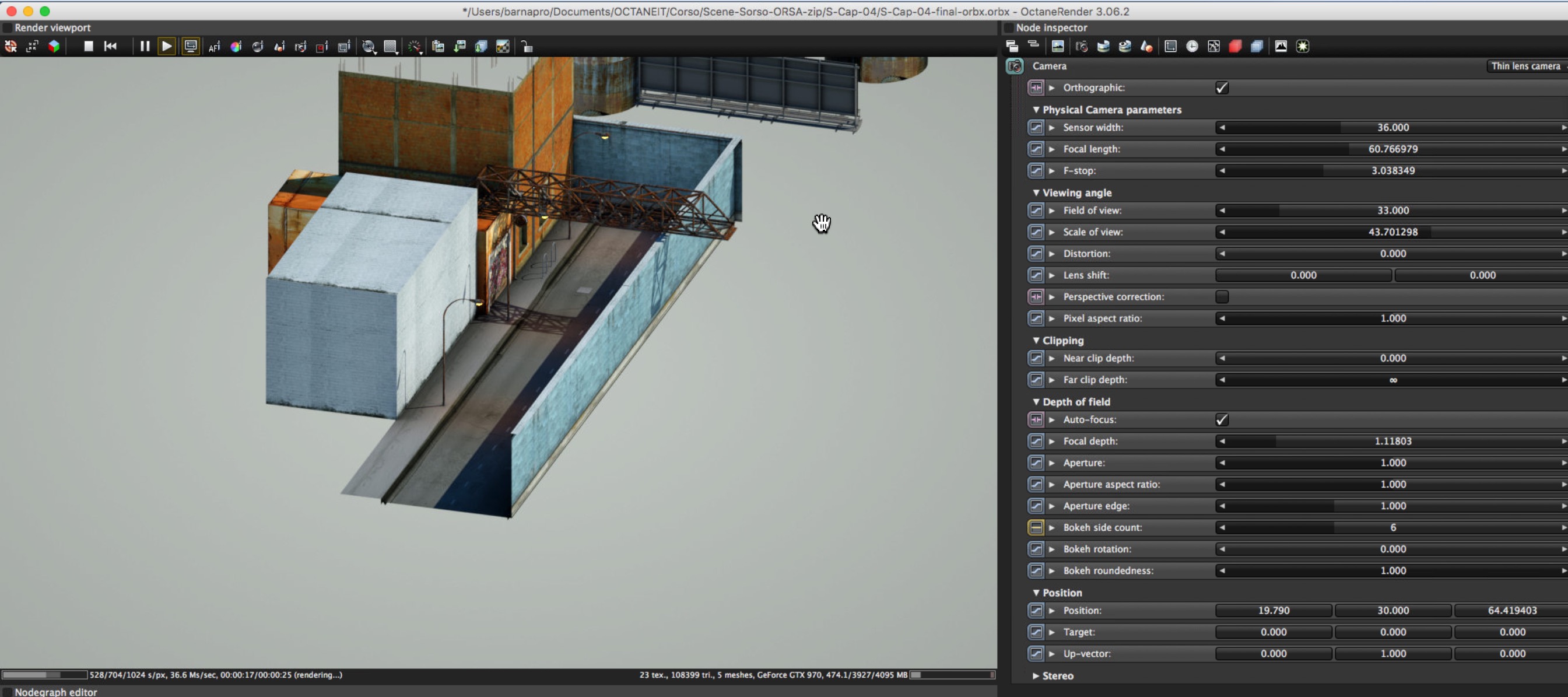

Anyway, if you go to the Thin Lense Camera node settings, you can tick the Orthographic projection mode, and adjusting Field of view, Position, and Pixel aspect radio to what you need:
