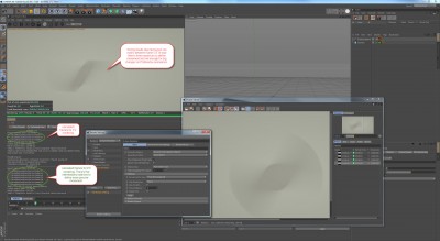

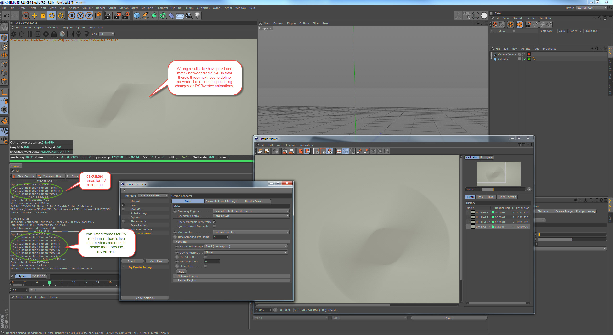

I've prepared a picture with notes to explain what's happening in depth. Additional information: When you scrub in timeline you need to go over a few frames to allow the plugin for storing enough frames. It's working with a caching system. For example, when you jump to frame 10, it will need to know PSR/vertex positions for extra frames(8,9/etc.. depends to shutter time and direction of mblur). So you can force to save it by going a few frames back.I've also noticed, as you've said, that if I restart the render in the LV, I'll get a preview of the correct motion blur, but if I move to another frame, the character or child object will then smear back out. Is there a control for time steps that I'm not aware of? Thanks
